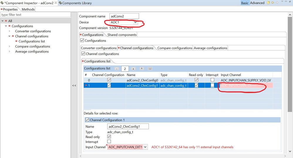

Hello NXP experts,
I'm using S32 Design Studio to configure CPU S32K142, package 64. It is strong and convenience : )
But I would like to have 2 questions
1st Question)
in Specification it notes that ADC0 has 16 external input channels

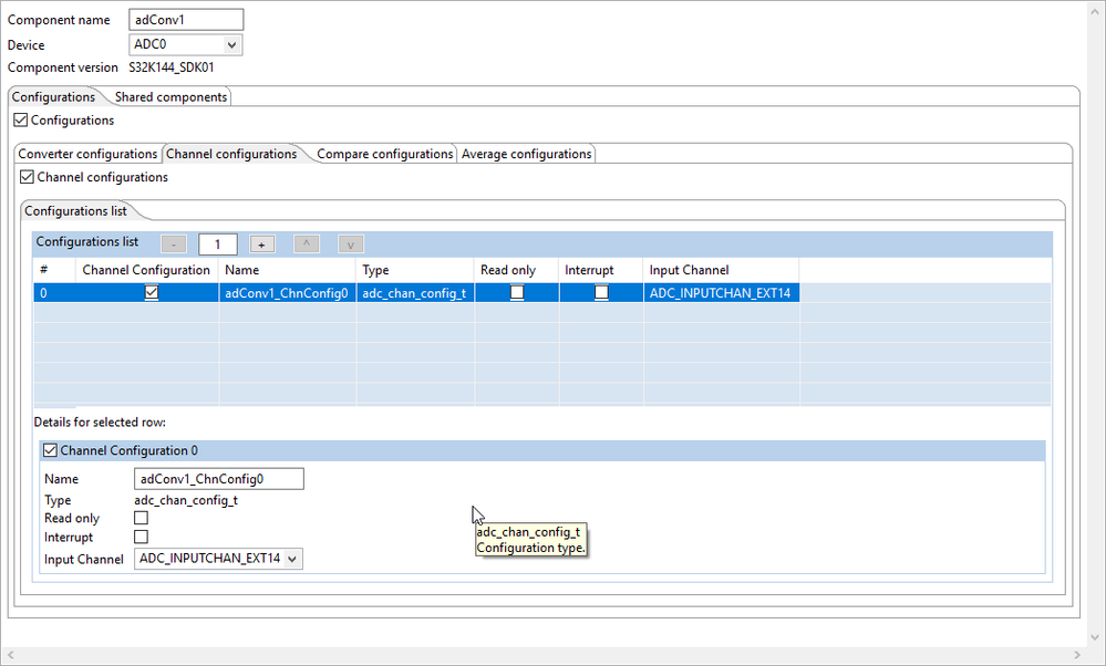

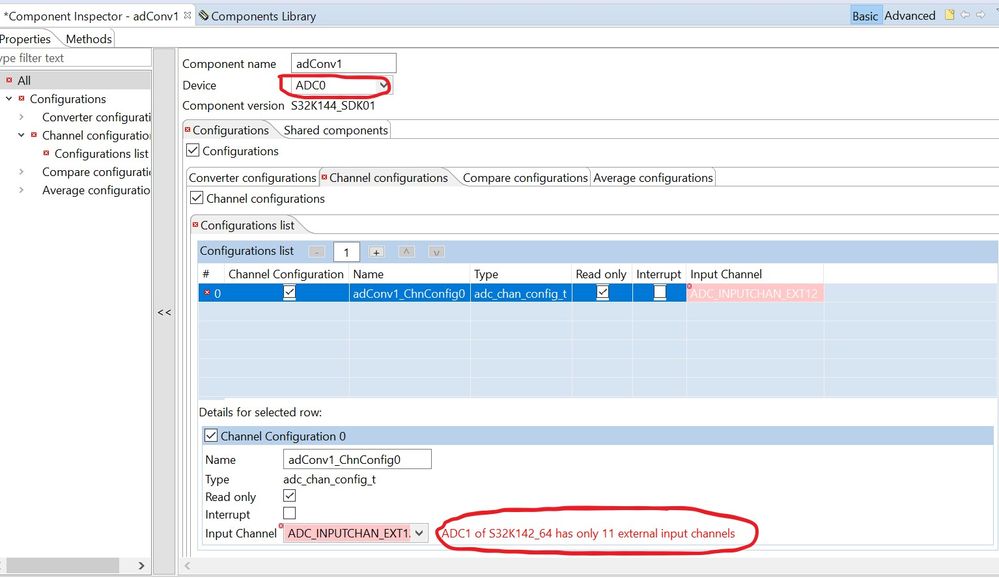

But when I configure ADC0 with external input channel 12 it always shows the error as ADC1 has 11 input only.
I think this is tool bug, how can I pass it to generate the ADC driver code correctly ?
2nd Question)

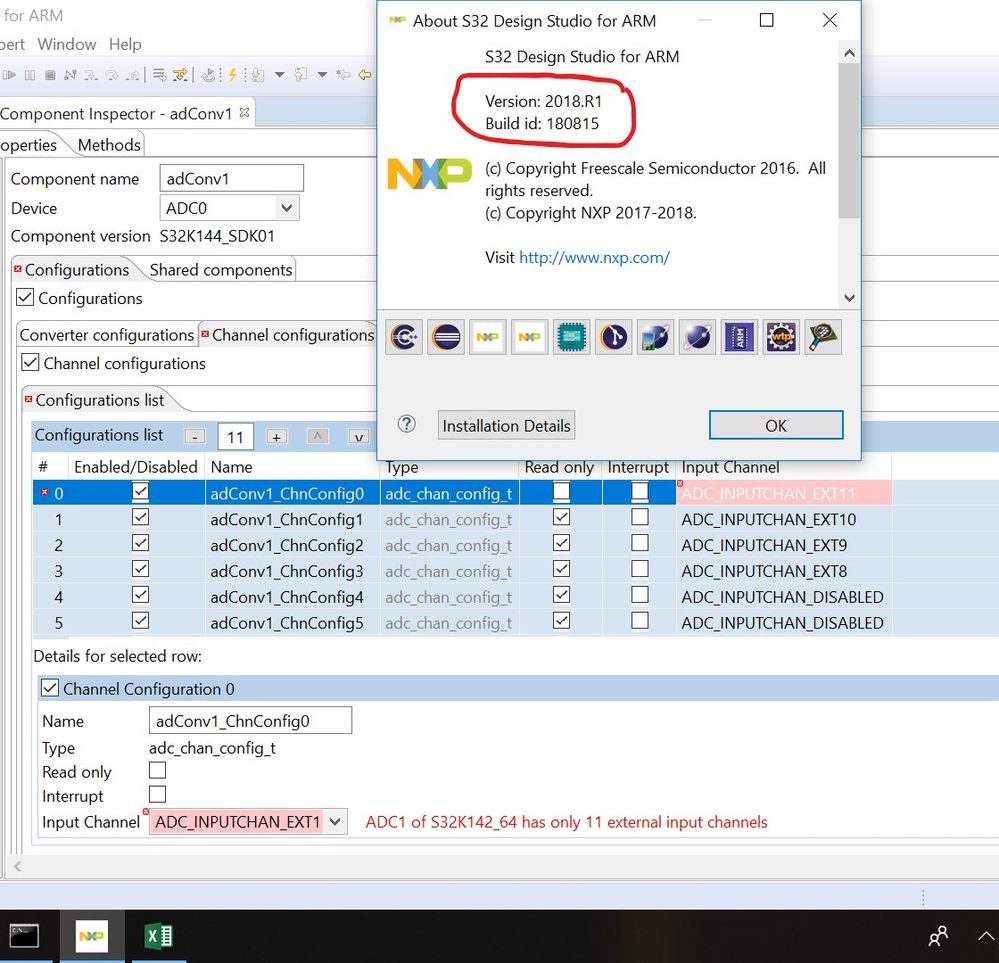

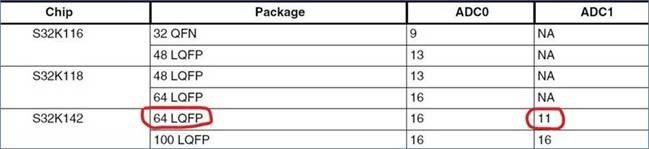

ADC1 of S32142-64 pins  has 11 external input channels only. But look at the Peripheral Pins mapping
ADC1_SE9 is not available while ADC1_SE11 is connected to pin 53. In that case from Processor Expert, if I configure ADC1 with external input channel 11, it should be OK. But it again shows the error ?
How can I solve this problem ?
Kindly check
Thank you
Anh.Nguyen

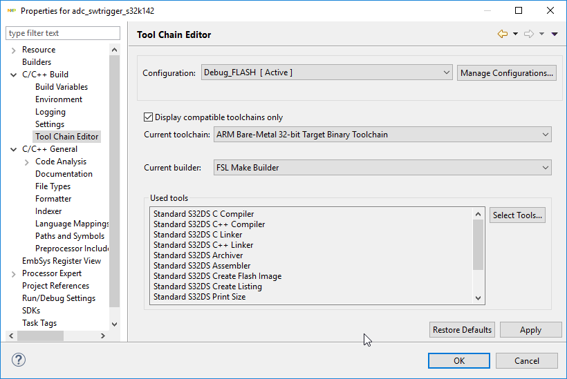

After changing the tool chain , I face with the new problem:
Build All error
Thank you alot
H.Anh

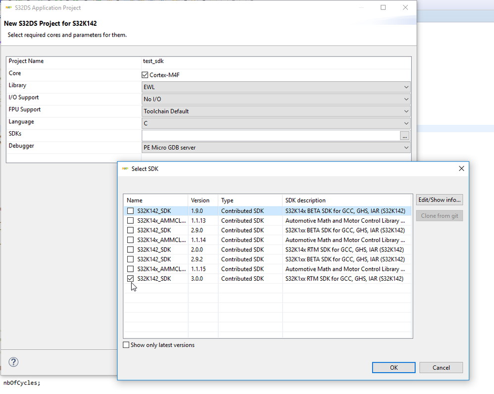

jiri_kral
Hi Anh,
to clarify - you have an older project and you are trying it migrate into latest SDK because of package layout error in SDK you was using, am I correct? Or you start with new project from scratch with older SDK? What was your SDK version when you switch it into RTM 3.0?
If the second cause is yours - (started with new project) - the easy way how to migrate it into latest SDK is just start again and select RTM 3.0 in project wizard:
Jiri

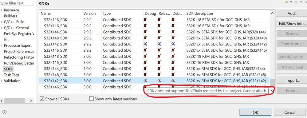

anh_nguyen
Hello again
I'm trying to replace SDK  RTM 3.0.0 but it is impossible.
Do you know the reason is why ?
Thank you

jiri_kral

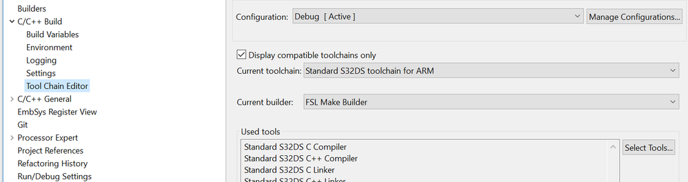

Yes, I'm using 64 pin package layout. What's your Toolchain? Latest SDK supports ARM Bare-Metal 32-bit target:
Jiri
7,867 Views
anh_nguyen
Hello Jiri,
It is standard S32DS toolchain, should I change to ARM Bare-Metal ?
7,867 Views

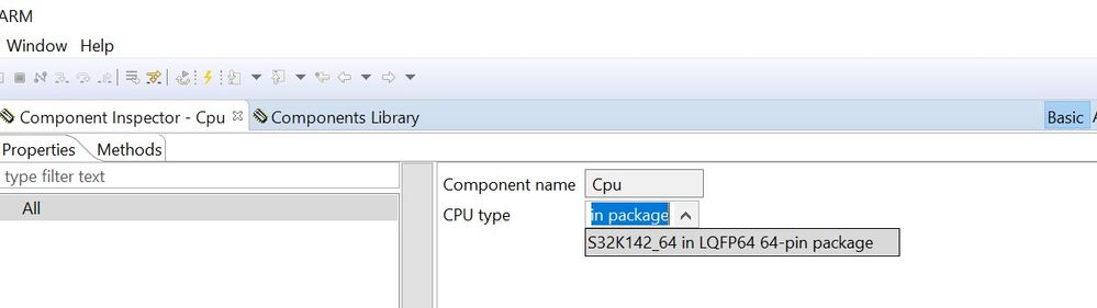

anh_nguyen
Hello Jiri,
Just confirm again, I'm using S32K142  64 pins package
If I configure ADC with S32K142 100 pins package there is no current errors

jiri_kral
please update your S32DS and use latest SDK version - RTM 3.0.0
https://community.nxp.com/docs/DOC-341068
In this version is ADC config working correctly:
Jiri

anh_nguyen
Hello Martin,
I am using version 2018.R1
Is it too old ? Is there any update package available ?
Thank you
