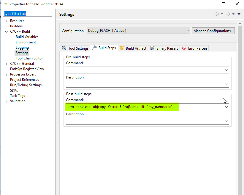

Hello, I want to rename the flash image file's name after build the project. I find that in project settings, Build Steps menu have post-build steps command. But I can't find the format of the command, or introduce of this function.
The format of the flash image is "ProjectName"_"BuildTime".s19, such as MotorDriver_20190228_221006.s19.
Could you help me?

jiri_kral
unfortunately there is a bug (already logged) - post build steps are executed prior s-record file is generated. You can generate s-record with your own name in post build step:
Hope it helps.

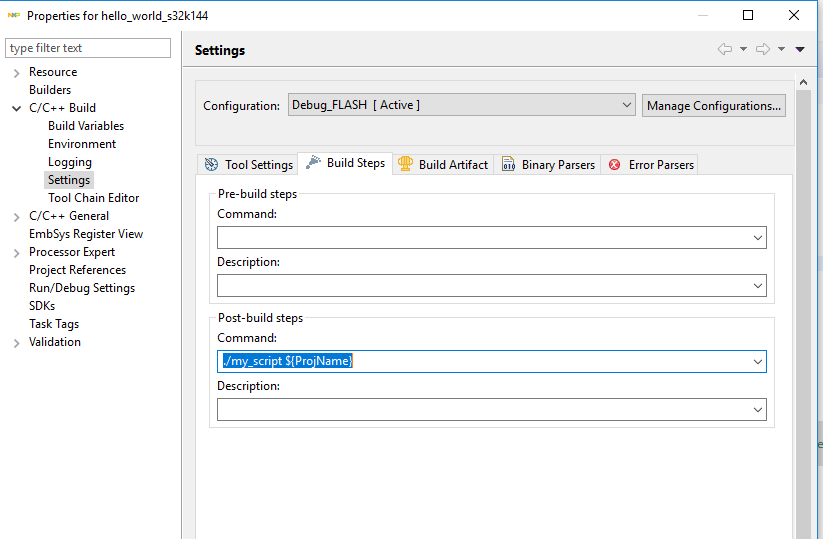

jiri_kral
I see - I didn't get that you like to add time stamp into file name - sorry. So, in this case - you need to add your commands into shell script - in attachment. Copy script into folder where your  .elf file is generated (for example Debug_FLASH) and add script and project name as an argument into post build steps:
After build you can find .srec file like this:
Jiri

cg0
hello Jiri
Thanks a lot. Yes, this is what I want to achieve.
