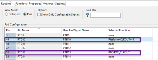

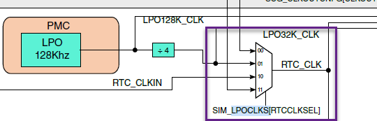

danielmartynek
1.
I tested the alarm example from SDK RTM 3.0.1 and the non-SDK example.
It was routed like this, but it really does not matter.
2.
The modified SDK example is attached, I only enabled the CLKOUT on PTD10 and RTCCLK_OUT on PTD13.
You don’t need to output LPO clock, but since you are using it and because the RTC module output was wrong, I thought that it would be good if you could measure that.
Yes, RTC_CLKOUT is definitely better then toggling an LED.
But again, you won’t be able to compensate the LPO error.
You need to configure this MUX only:

Hi anoop.radhakrishnan.nair.007@gmail.com,
The RTM module in this SDK example is using the LPO 128kHz clock divided by 4 which should give 32KHz.
The RTM clock would need to be 32.768 kHz, to get exactly 1s RTM CLKOUT
(LPO clock would need to be 32.768 kHz * 4 = 131.072kHz).
The oscillator is not precise, as you can see S32DS rev.11.
It is tre-trimmed to around 128kHz (PMC_LPOTRIM), but one LPOTRIM[4:0] step gives about 3kHz difference.
And therefore, the LPO clock can differ significantly part-to-part.
You can measure the LPO frequency externally at a CLKOUT pin (see above SIM_CHIPCTL[CKOUTSEL]).
Please have a look at the Time Compensation Register description in the RM.
It can compensate 32,768kHz - TCR (where TCR is a twos complement sign extended value).
Using the RTC_CLKIN (external clock) is the only way to get 1s RTM CLKOUT.
