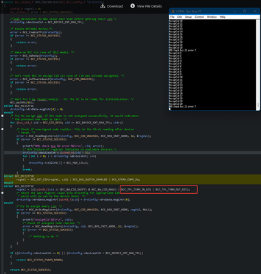

I have RDVCU5775EVM and RD33771CNTREVM.
There are 20 MC33771C ICs in total. I'm trying to bind them with TPL. But I am not successful. I guess the CID assignment is not successful. Is there something I need to change in the PDC_5775B_SDK software?

Hi Peter,
another customer came across similar issue. The customer also tries to assign Cluster ID to the MC33771C. There wasn't a problem with software, but with ringings in the TPL communication. Please check the following community thread: https://community.nxp.com/t5/Other-NXP-Products/MC33771C-TPL-2nd-Node-dont-respond/td-p/1394866
Please measure the message on the TPL line and see if the line looks similar. The ringings is described in AN12605.
