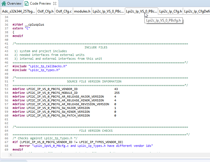

Hello! I am trying to do an example project for I2C Master output and found the I2c_IP_LPI2C Transfer_S32K344 project to fit my needs.
I got pretty far but I'm met with a compilation error where the I2c_Lpi2cMasterChannel0_VS_0 and I2c_Lpi2cSlaveChannel1_VS_0 is not found.
A little more digging and these are suppose to be the initialization structures for the I2C Init functions. These are defined already in my configuration.mex file but I'm not sure how to generate it using the ConfigTools.
When checking the generated files from the ConfigTools, Lpi2c_Ip_VS_0_PBcfg.h is empty and it looks like Siul2_Port_Ip_Defines.h is not generated. The Siul2_Port_Ip_Defines.h looks to be a very standard file that is easily copied and pasted from the source but the Lpi2c_Ip_VS_0_PBcfg.h looks to be the file that would hold the structs I'm interested in. Though, I'm not too sure about this and would like to check.

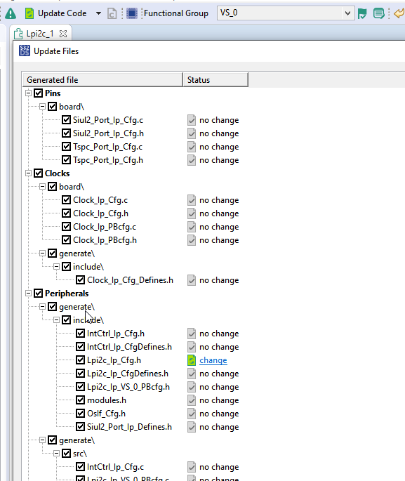

danielmartynek
Hello @nwKodiak,
Which RTD version do you use?
I have tried with:
* Autosar Version : 4.4.0
* Autosar Revision : ASR_REL_4_4_REV_0000
* Autosar Conf.Variant :
* SW Version : 1.0.0
* Build Version : S32K3_RTD_1_0_0_P02_D2111_ASR_REL_4_4_REV_0000_20211115
And all the files are generated and I can compile it without any issues.
Do you see any error when you update the code:
You can preview the files:

danielmartynek
Do you see any error when you click on Update Code?
What OS do you use?

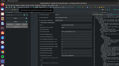

nwKodiak
Hey Daniel,
I do not see any errors on the Update Code button. Also, I am using Ubuntu 20.04.3 LTS.

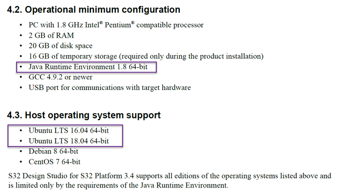

danielmartynek
Hi @nwKodiak,
According to S32DS34 Release notes, Rev. 2.0, 04/2021
Ubuntu LTS 20.04 is not supported
BR, Daniel
