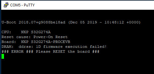

I'm having some trouble booting the s32g274aevb, see attached image.
I have tried with several pre-built images (binaries_auto_linux_bsp22.7/23.0/23.1) and also building myself.
I've tried flashing the SD card with win32diskimager, balenaEtcher, and linux dd from virtual machine.
The switches are set according to the boot from SD mode for s32g274aevb in the Auto Linux BSP User Manual.
Following the same steps works fine for booting on s32v234sbc.
Any ideas what might be causing the problem?

Hello Peter,
Problem was solved on Thursday last week. The chip was not mounted properly on the board...
Thank you for your efforts :smileyhappy:
