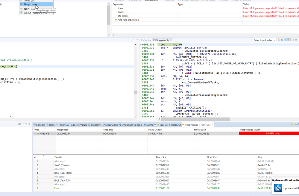

Since you're using FreeRTOS you can enable the Task List view that shows the usage of the heap that each task has:
In the heap usage view you can see how much free space you have:

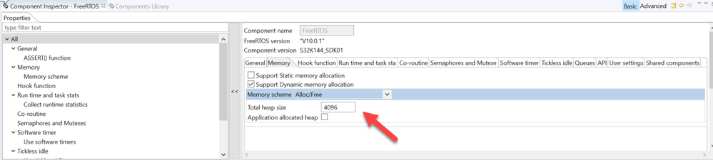

Also, in the FreeRTOS component you have you can set how much of the memory the heap will use:
So, knowing how much of the heap the task will use you can modify the stack usage in the xTaskCreate to fit the needs of your task.

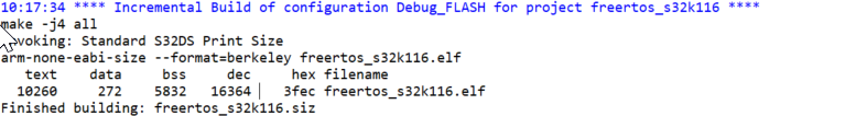

Can you let me know how are you adding these components? I'm using the FreeRTOS example that comes with the SDK, this is the example size without modifications: pastedImage_1.png

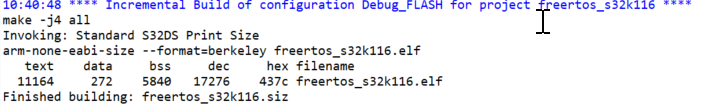

After adding a simple task this is the size:
And after adding the semaphore support this is the size:

I also did the same process as you but the difference in size is around 1Kb, so I'm thinking this could be due to the software difference.
I'm using the S32 Design Studio 2.2 so you could try updating the IDE.
