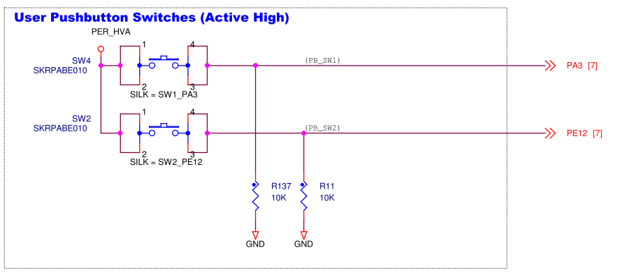

I use the DEVKIT-MPC5748G to do external interrupt and the DEVKIT of button are PTA3 and PTE12.
I am stuck for a while with External interrupt, I can trigger PTE12 into interrupt, but the PA3 can't trigger interrupt.

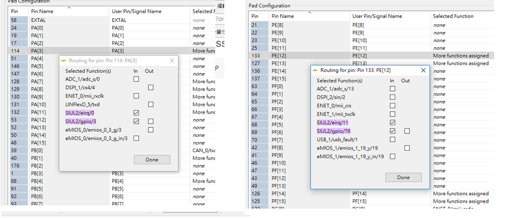

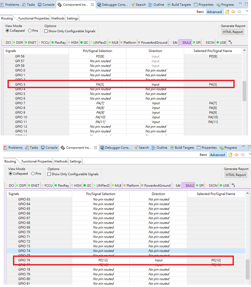

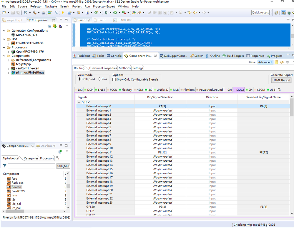

And setting the "pin_mux:PingSettings" of PE.
I set the External interrupt 0 is PA3 and  External interrupt 11 is PE12.

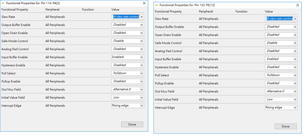

2. Change Interrupt Edge to be "Rising edge"
3. GPIO Set to be input
4. Pin assigned to be SUL2/eirq/0 and SUL2/eirq11.
