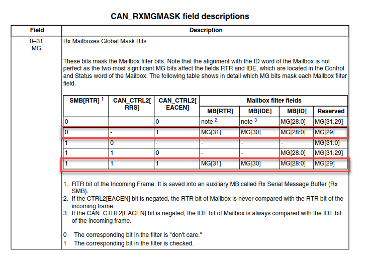

My OS is freertos,and components version is S32_SDK_C55
before I receive can data ,I must config first,but I don't know what kind frame I will receive(extended ID and standard ID)
Now I can only receive 1 kind frame in the same MB.
What's the solution about this?

If the CAN_CTRL2[EACEN] bit is negated, the IDE bit of Mailbox is always compared with the IDE bit
of the incoming frame, thus to receive both standard and externed IDs you need at least 2 MBs configured for the receiving.
You can try to set the CAN_CTRL2[EACEN] bit, then bit 30 of the masking register specify if IDE bit is don't care or not.
If you clear the rest of mask register bits (MG[28:0]) then the received ID is don't care too and all messages should be received into single prepared MB.
BR, Petr

thanks for the suggestions - it worked for me.
I was planning to use only one MB. This is how I set it up:

              // set the EACEN bit to enable mask on MB[IDE]
              CAN_0->CTRL2 |= CAN_CTRL2_EACEN(1);
        	FLEXCAN_ExitFreezeMode(base);

    // set the Mask to receive all the messages
    FLEXCAN_DRV_SetRxMbGlobalMask(INST_CANCOM1, FLEXCAN_MSG_ID_EXT, 0);
