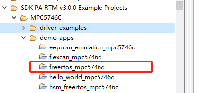

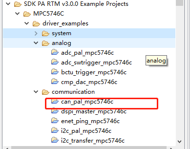

MPC5746C error, jump to IVOR1_Handler interrupt, a dozen processors are like this, using the official demo, has anyone encountered a similar problem?

What does official demo means? Can you post a link to your HW and SW?
or share it with us?

Hi,The currently used IDE is
‘S32 Design Studio for Power Architecture Version: 2.1’.
The SDK used is SDK PA RTM v3.0.0.
Get the demo version from the SDK, as shown below:

Thank you very much for your answer. I seem to have found the problem. Currently, there is no OSC32K external pin in the MCU of the MPC5746C 100MAPBGA, and MC_ME.DRUN_MC.SXOSCON is enabled in the Demo of the SDK, but it does not judge and wait for MC_ME.GS. The .B.S_MTRANS bit is set to 0, so the program jumps to the IVOR1_Handler interrupt when the PIT register is manipulated.
It seems that the officially provided Demo Code does not distinguish the 100MAPBGA of the MPC5746C from other Pin packages.
