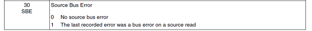

ke_liang
I see the Error Status Register (DMA_ES) in S32 IDE memory window, the value is 0x80000102.  Correspond to the figure below.
But I dont how to do.
