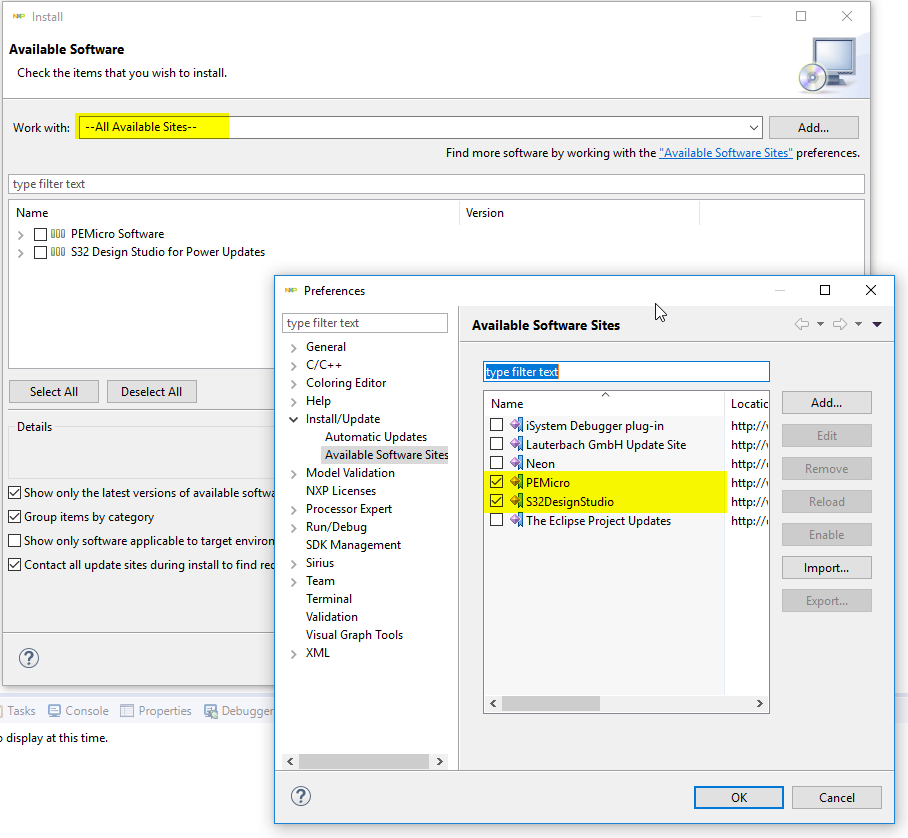

So do I,I can not compile at S32 Design  Studio for Power,can not find the SDK,but it is OK that I create a new project.What is the problem?
3,394 Views
jiri_kral
Normally users create new thread when the topic doesn't match existing thread. So - anyway, please install updates for your S32DS:
Hope it helps.
Jiri
