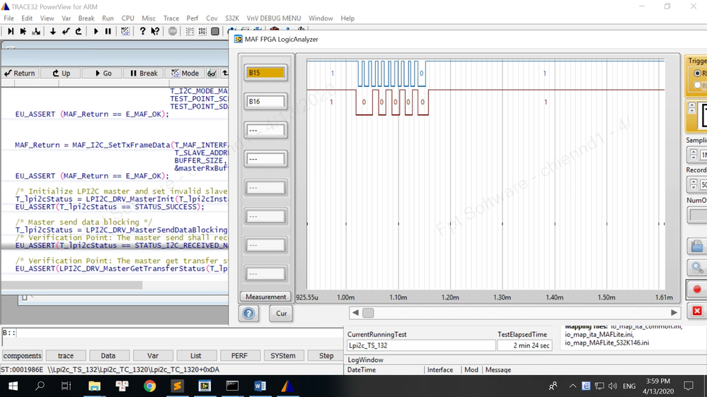

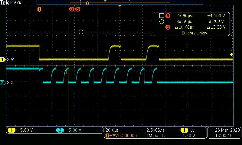

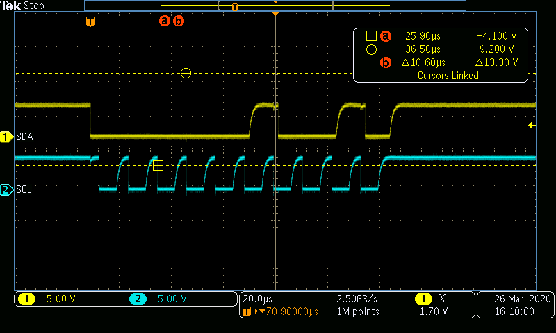

Hi, everyone,
I am supporting customer CA on LPI2C, and  found LPI2C will be stuck( SDA and SCL are hold low) with baudrate 100KHz when a NACK is received after writing an incorrect address to slave node. And I use PD driver API LPI2C_DRV_MasterSendDataBlockingdata() to send data, and the phenomenon only occurs when set SDK optimization level -O1 which is default setting. I test the issue using our SDK RTM3.0.0 demo project named "lpi2c_master_s32k144", the IDE is S32DS.ARM.2018.R1 and the EVB is S32K144EVB-Q100 with part number 700-29248 Rev A.  I suspected it maybe a SDK bug, because i also test the phenomenon with baudrate of 400KHz with different optimization (-O0 and -O1), SDA and SCL are all release after NACK received.
According to the section 3.1. 6 in I2C-bus specification and user manual, it will lead to generate a NACK when no receiver is present on the bus with the transmitted address, so there is no device to respond with an acknowledge. In order to generate NACK, i use one S32K144 EVB as master and another as slave, and master send incorrect address to slave node. The following two images are I2C bus timing sequence, respectively corresponding to different optimization image Optimization Level None(-O0) and Optimization Level Optimize(-O1) and baudrate is 100KHz.
   image 1.  Optimization Level None(-O0)
   image 1.  Optimization Level Optimize(-O1)
Could anybody help check whether it is a SDK bug?

nxf54196
Hello Han,
With 100kbps baudrate and -O1 optimized flag, the Lpi2c could not handle fast enough to shift STOP bit out bus before FIFO is reset on error interrupt handler. So i think that STOP bit is stuck on the shifter. I tried with no resetting FIFO on the interrupt handler, and saw that STOP bit appeared on bus as expectation.
Manh

AlinaB
Hello Han,
I think that it was indeed a problem in the RTM 3.0.0 release.
The issue is not reproducing with the latest driver code, which will be available in RTM 3.0.3 release. We have tested again, this time using -O1 optimization level, using gcc and ghs compliers,. The SCL and SDA lines were both high after receiving NACK.
Alina

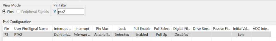

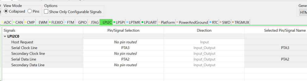

nxf47370
Hi, Alina,
I use PTA2 pin as SDA, PTA3  pin SCL, and enable internal pull-up for the two pins configured as following image. I have not used external pull-ups fro each line.
I test it again and find that it will return STATUS_I2C_RECEIVED_NACK  in every situation you mentioned after the LPI2C_DRV_MasterSendDataBlocking() function, and when that happens I call LPI2C_DRV_MasterDeinit() to find the SCL and SDA can be back to high.
Finally, there is the same between  without a slave connected and with a slave.
