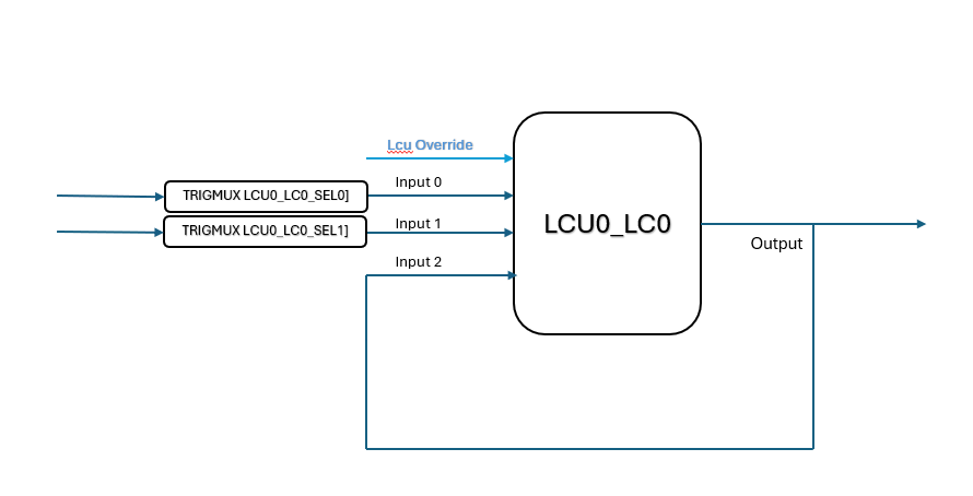

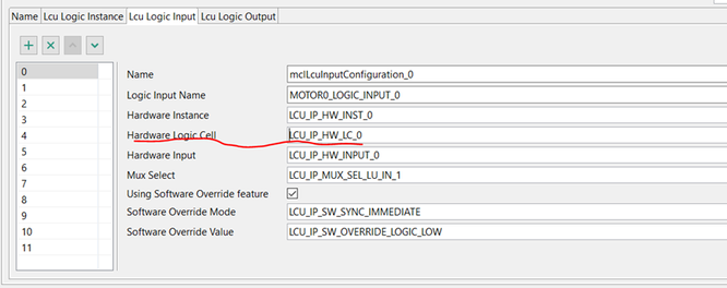

Hello Team,
I am working with an LCU module configuration with three input and one lcu override and one output as shown below
  • For this 3 input and one lcu override how to perform the configuration, do we need to create separate LcuInputConfiguration containers for each input?
  • Please give an idea on how to configure the input 2 (feed back from the output) and how to configure the lcu override.
  • On what basis we are giving the values lcuLogicInput_MuxSelect for each input?
It will be appreciable if anyone can provide an example configuration and coding that will help this configuration.

1.For this 3 input and one lcu override how to perform the configuration, do we need to create separate LcuInputConfiguration containers for each input?
       An LCU is composed of 3 independent LC modules, each of which has four inputs and outputs. So according to the content of your picture, I think one LC is enough.

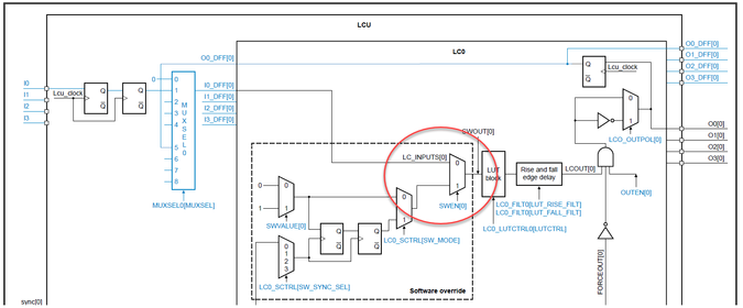

2.Please give an idea on how to configure the input 2 (feed back from the output) and how to configure the lcu override.
The output of LC can be directly selected as the input of LC, which I have highlighted in the picture.

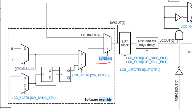

        Software Override is actually very simple. You can see the schematic diagram given in the data sheet. In fact, you only need to modify these two registers (I have highlighted them)
"To use software override, you must enable it for the corresponding output (SWEN[SWEN]). You assert software override by writing 1 to the corresponding bit of the Software Override Value" (SWVALUE[SWVALUE]).

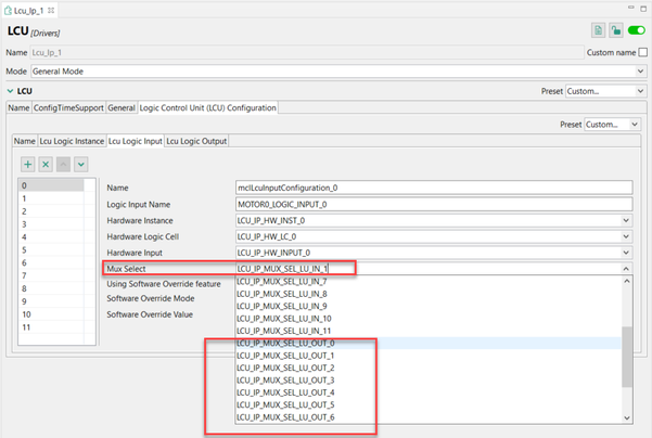

3.On what basis we are giving the values lcuLogicInput_MuxSelect for each input?
    I don't know how to explain this question better.  its input needs to be based on your own needs.
     The module input of LC can come from TRGMUX(or self), and the input of TRGMUX can come from many modules, such as external ports, eMIOS modules, etc.It's all depend on your needs.

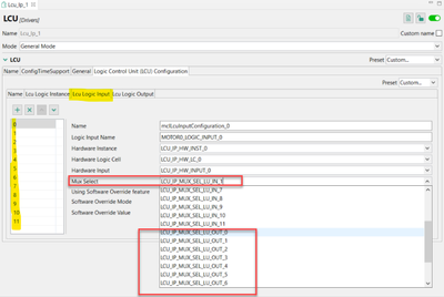

Regarding the third query i was asked about the mux select.
  • Here we have so many mux values are available, so on what basis we select its value. In this figure i can see that 12 containers are created inside main container 'LCU Logic Input'(highlighted part), so do you have 12 inputs and created one container for each input? If so, on what basis we are selecting 'Mux Select' for each inputs?
  • In my application, input one and two coming from trigmux LCU0_LC0_SEL0 and LCU0_LC0_SEL1 so what value of mux i can select for input one and two?

Q1:Here we have so many mux values are available, so on what basis we select its value. In this figure i can see that 12 containers are created inside main container 'LCU Logic Input'(highlighted part), so do you have 12 inputs and created one container for each input? If so, on what basis we are selecting 'Mux Select' for each inputs?
You can see each LCU instance have three hardware logic cell which is :
LCU_IP_HW_LC_0, LCU_IP_HW_LC_1 and LCU_IP_HW_LC_3
each hardware logic have 4 input choice
For Mux Select:
LCU_IP_HW_LC_0  can choose :
              LCU_IP_MUX_SEL_LU_IN_0 ~ LCU_IP_MUX_SEL_LU_IN_3
LCU_IP_HW_LC_1 ->
             LCU_IP_MUX_SEL_LU_IN_4 ~ LCU_IP_MUX_SEL_LU_IN_7
LCU_IP_HW_LC_2 ->
             LCU_IP_MUX_SEL_LU_IN_8 ~ LCU_IP_MUX_SEL_LU_IN_11

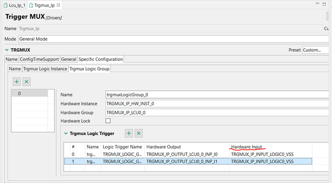

Q2:In my application, input one and two coming from trigmux LCU0_LC0_SEL0 and LCU0_LC0_SEL1 so what value of mux i can select for input one and two?
You should use TRGMUX module to select input source for LCU0_LC0_SEL0 and LCU0_LC0_SEL1.
("Hardware Input" depend on your needs and application.)
For example,Here i config LCU0_LC0_SEL0 and LCU0_LC0_SEL1  are both choose
TRGMUX_INPUT_LOGIC0_VSS as input source.

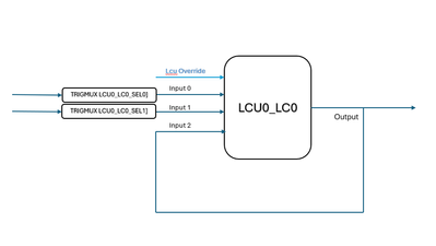

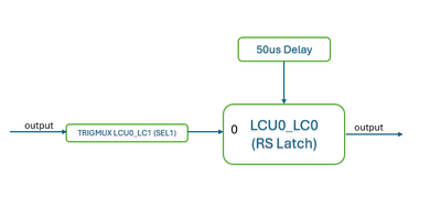

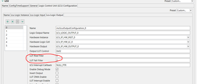

1. As per our requirement we have to give one delay in LCU0_LC1 as shown below
How can we give this delay to LCU0_LC0, is it given through configuration or coding?

Senlent
Hi@emerging
Q1.you can configurate it directly
Q2.From the picture your provided, you just need to init and enable the LCU out.
Lcu_Ip_Init(); /* initialize the LCU module */
Lcu_Ip_SetSyncOutputEnable(); /* Apply LCU output configuration */

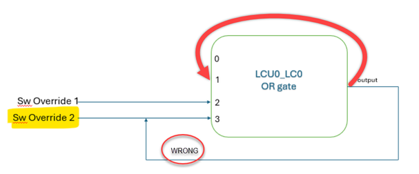

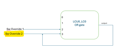

But unfortunately i have one more block.
As you can see above i have two sw override in input pin 2 and 3 and i am able to control pin 2 in software by enabling sw override and i control the output as one and zero. But the second override with latch i am not able to control
I made the pin 2 as one with sw override and checked and confirmed the corresponding output is one and the output is latched to 3rd input,so even after i made the pin2 low the output is maintained as one because of output latch. Till this its working,but after i am trying to change the 3rd input pin as zero i am expecting my out will be zero because both the input 2 and three as zero. but unfortunately the output is keeping as one.

Senlent
Hi@emerging
For LC0 input 3 channel, you cannot apply LC0 output and SW OVERRIDE to channel 3 at the same time. This is incorrect.
You can change it like below picture shows.
8,096 Views
emerging
Hi @Senlent ,
  • Actually sw override means it override another input value. But here your point is, sw override can override all other inputs other than a latch input from an output.
  • We can enable software override for each inputs separately
Could you please confirm my understanding is correct or not?
Thanks and regards
8,089 Views
Senlent
Hi@emerging
This is a selector where only one input can be active at a time.
