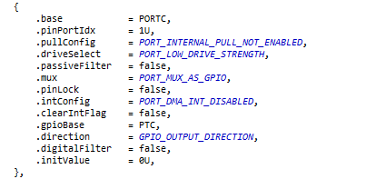

Hi @DenisT1980,
I can't reproduce the issue.
When I create a project from example,
hello_world_s32k146
PTC1 is a GPIO output by default
the pin_mux.c file is generated correctly:
Can you test it with that example?
Do you use Linux?
BR, Daniel

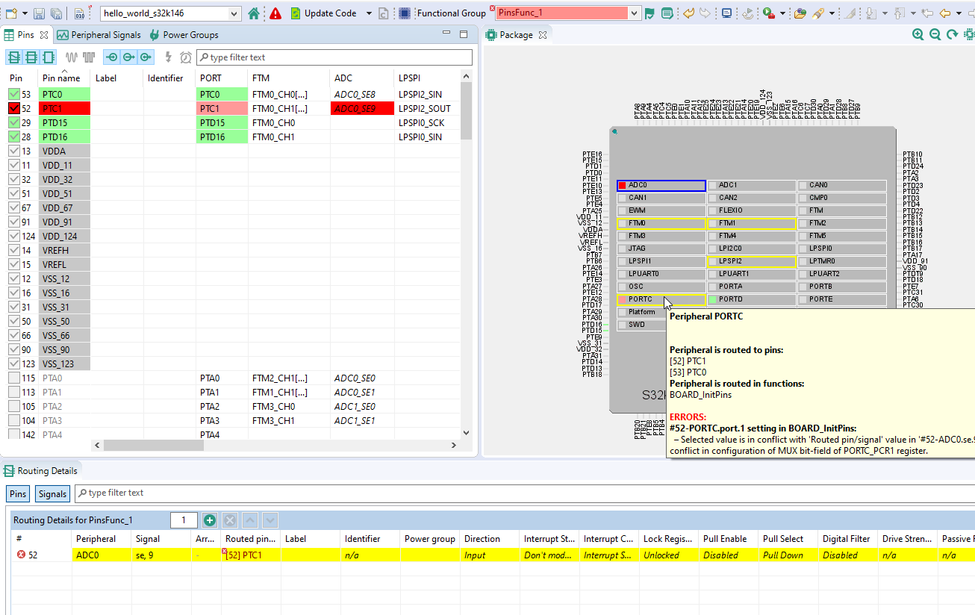

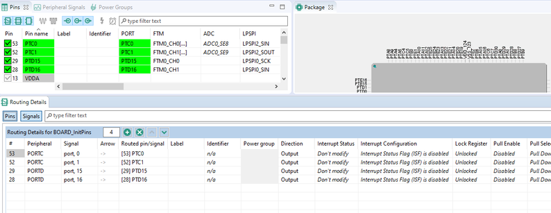

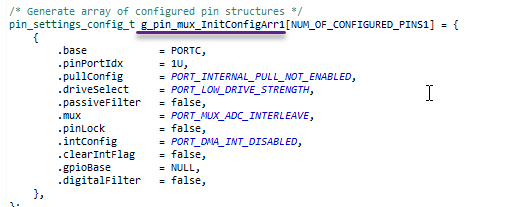

DenisT1980
I have made my own research. As I have understood the fault occurs, if the pin is configured for more than one functional group.
I have created the test project from example „hello world“, as you described. The pin configuration in functional group „BOARD_InitPins“ was OK. Then I have created the new pins functional group „TestFuncGroup“ and configured for this group the PORTC1 as ADC channel 9. Now is the configuration for PORTC1 in BOARD_InitPins wrong.

danielmartynek
Hello @DenisT1980,
I juts tried to reproduce it, but it gives me an error that the pin is already configured in the default BOARD_InitPins function group.
BR, Daniel

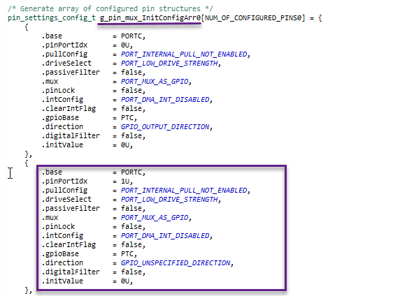

DenisT1980
Please, check if both functional group are marked as "Called by default initialization function". Select only one function group.
2,251 Views
danielmartynek
Hello @DenisT1980,

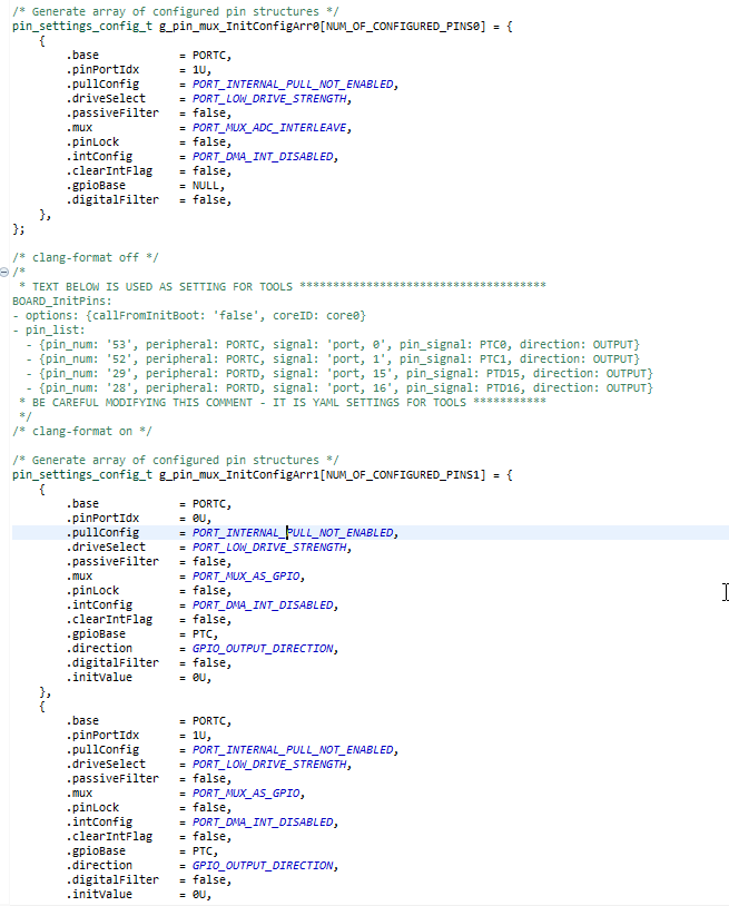

You are right, PTC1 has GPIO_UNSPECIFIED_DIRECTION in Arr0
But if I move the second group up like this:
It seems to be good,
1,969 Views
DenisT1980
But this make all my GPIO pins to OUTPUT, also such that are configured as INPUT!.
