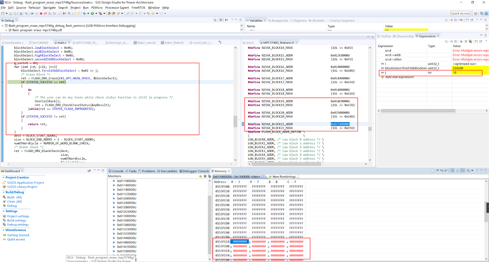

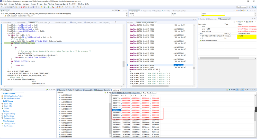

tajo
   I try to debug with the example, for that I want to find out when the problem will happen while which blosck being erased. There was someting strange.
    When I am erasing the 20th 256kb block(while j == 19),  the last block (from 0x01540000 to 0x0157FFFF) will be erased?Emmmmmm...
