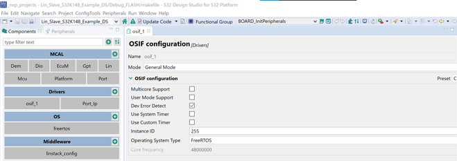

I imported the example project Lin_Slave_S32K148_Example_DS and added the freeRTOS component. The code generation does not indicate that any problems occured, but the final Console output while attempting to build the project yields

Since I only added the freeRTOS to the example project Lin_Slave_S32K148_Example_DS I want to understand why building this project fails and what (configuration, peripherals,...) I am missing.
Maybe the following information help:
Installed Software
  • S32 Design Studio S32K1XX SDK RTM 4.0.3
  • FreeRTOS S32K1 1.0.1
  • LINSTACK S32K1 1.0.1
  • RTD S32K1XX 1.0.1 (HF)
  • TCIP_STACK S32K1 1.0.1
Peripherals - Components (Overview)

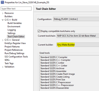

Hi @M_SCH,
Could you change "Current builder" to the below image and re-build project?
I attached an example that I built successfully from my side.
Dan
