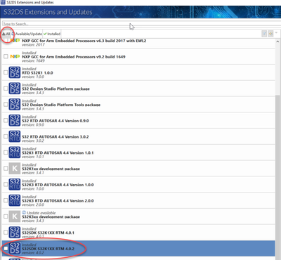

I am trying to install S32SDK S32K1XX RTM 4.0.2 but after install the downloaded exe the IDE doesn't recognise the installation. There are some guide describing the instalation throught .zip file but on downloads only are there the exe.
How to indicate to S32Design Studio to use my already installed S32SDK S32K1XX RTM 4.0.2 ?

Hi @sergiverdaguerelausa
Which version of S32DS are you using?
This S32 SDK is delivered bundled in the S32 Design Studio v3.4. In this case, it’s already configured and ready to use.

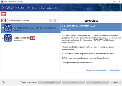

Hi @VaneB
I am working with S32 Design Studio for S32 Platform 3.4 version.
On S32DS Extensions and Updates there is S32SDK S32K1XX RTM 4.0.3 but I want install 4.0.2.

VaneB
You should be able to find it at Help -> S32DS Extensions and Updates

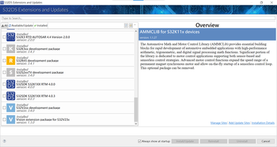

I'm running S32DS 3.5, and Only "RTM 4.0.1" shows in my list.  I don't seem to have access to the "RTM 4.0.2" version.
As you can see on the screenshot I don't have 4.0.2, only the last one.

VaneB
Download S32 Design Studio 3.4 S32K1xx Service Pack 1 (SW32K1_S32DS_3.4.1_D2106.zip) at My NXP Account -> Software Licensing and Support -> Software accounts and add it as an updated site.
Hi @VaneB
It works!
