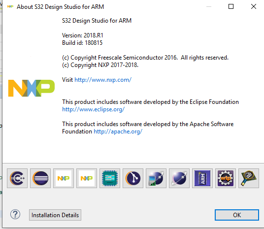

EE_CW
Hi Stan
I'm using S32DS.ARM.2018.R1
As MCU I target a S32K148
Mario
