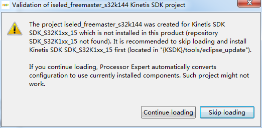

I installed S32K1_ISELED_RTM_3.0.0 in the directory of S32SDK_S32K1xx_RTM_3.0.0 . Then create the project from Example , and the error report like below:

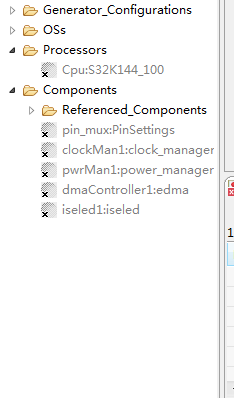

and the component like below:

jiri_kral
please update your S32DS Instalation - https://community.nxp.com/docs/DOC-341068
With latest updates can be iseled example build without any issue.
Hope it helps.
Jiri
853 Views
victor_song_171
It‘s worked,and thanks for assistance.
