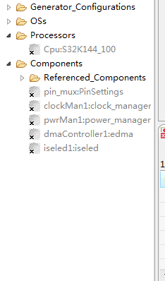

I installed S32K1_ISELED_RTM_3.0.0 in the directory of S32SDK_S32K1xx_RTM_3.0.0 . Then create the project from Example , and the error report like below:
and the component like below:
What should do ? thanks for any assistance.
PS: Just installed "Hooks for S32DS S32K1xx RTM SDK 3.0.0" and "S32 DS S32K1xx RTM SDK 3.0.0" and "S32 DS S32K1xx RTM SDK 3.0.0 path"

please update your S32DS Instalation - https://community.nxp.com/docs/DOC-341068
With latest updates can be iseled example build without any issue.
Hope it helps.
Jiri
