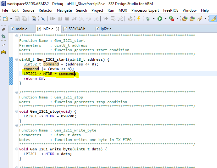

I am trying to perform a loopback I2C communication between I2C1 and I2C0. Here I2C0 is configured in slave mode. Trying to generate I2C clock from I2C1 master, which is not happening. I checked the status of MTDR register by updating it with slave address and the command to to perform repeated start. I found the register not getting updated with the bit values. Not able to figure out what possibly could be the reason. What areas should I check to debug this issue?
Another doubt it, do I have to configure CGC, PCS and PR of PCC register for I2C0 which is acting as a slave or for slave these fields shouldn't be configured as master controls the clock? Master code to STARTMaster code to STARTPCC configuration  for I2C slavePCC configuration for I2C slave
Thanks in advance.

Since you are using S32 Design Studio for ARM Version 2.2, please refer the lpi2c_master_s32k148 and lpi2c_slave_s32k148 example in S32SDK S32K1xx RTM v3.0.0 Example Projects.
