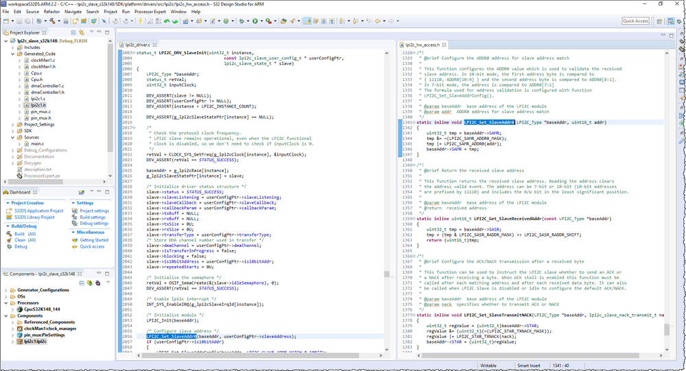

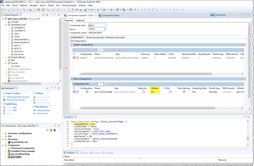

I need to configure S32K148 board in I2C slave mode. How do I set the slave address of the device or is the slave address already given? I couldn't find it in RM or DS.

Robin_Shen
Hi Soniya Chandran,
Please refer the lpi2c_slave_s32k148 in S32SDK S32K1xx RTM v3.0.0 Example Projects.
Robin
