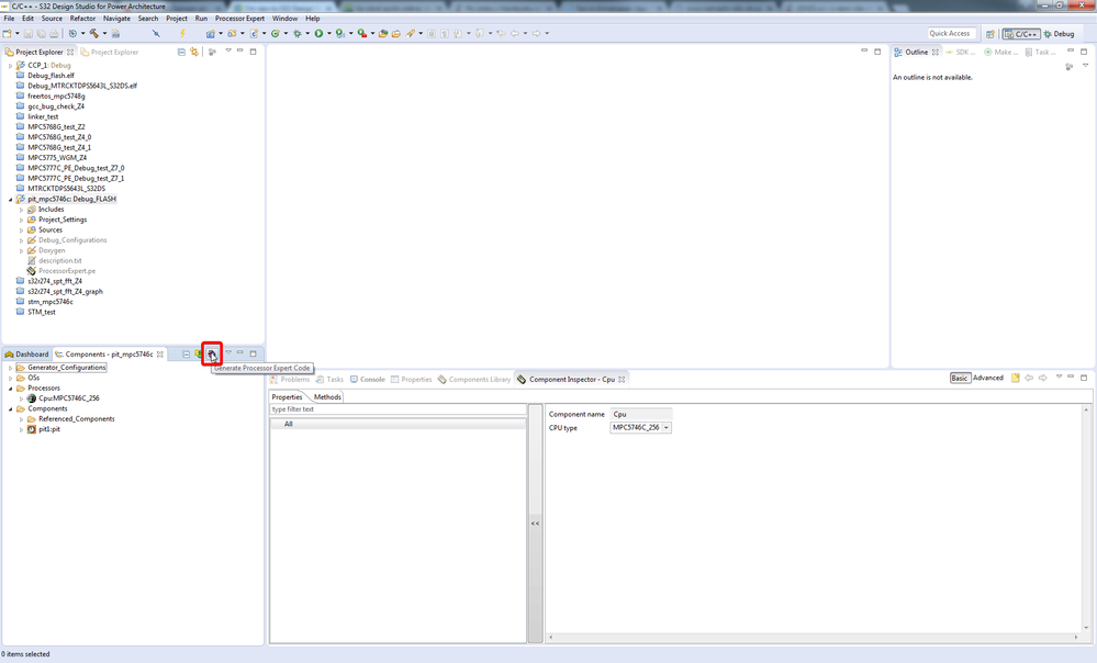

I've created a blank project, opened up the PE view, using the EAR SDK and added ADC, LPIT, WDOG, INTManager components to the project and tried to generate PE code.  I got an error "adc_hal.h: No such file or directory" in cpu.h so I added the adc_hal component to the project and tried again. Same error.  Digging into Project Explorer I found fsl_adc.hal.h buried in Project/SDK/platform/hal/inc but no evidence of adc_hal.h.

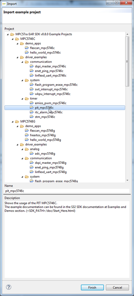

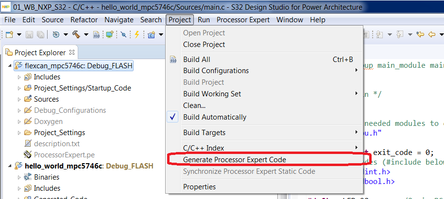

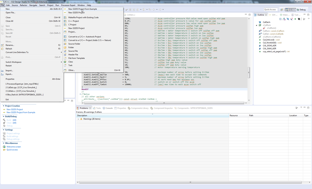

As a best way how to started with S32DS EAR sdk and processor expert is open some example. On menu bar click on File -> New -> S32DS Project from example , choose project which you are interested in and don't forget generate procesor expert code (icon in the red box) on the last picture.
Documentation is located in [YOUR_S32DS_INSTALL_PATH]\S32DS\S32_SDK_MPC5748G_EAR_0.8.0\doc\

for those who still can not find. First Generate Processor Expert Code. the tool will generate 'Cpu.c' and 'Cpu.h'

Thanks for getting back to me.  I didn't scroll far enough down the list of examples to find the ones using PE.
