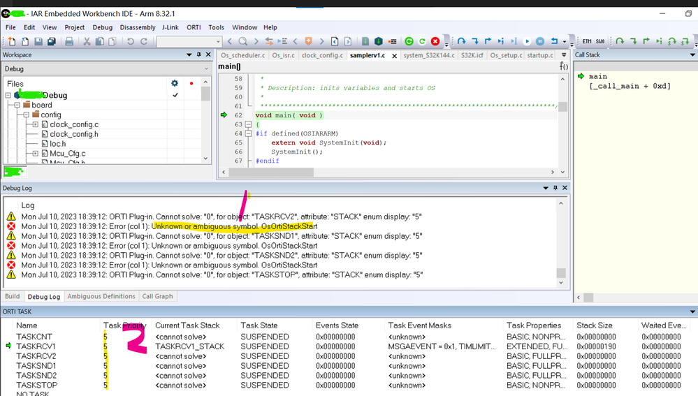

I use S32K_ AUTOSAR_ OS_ 4_ 0_ 98_ RTM_ 1_ 0_ 0 for sample1 debugging. Using the default sample1. ort file (due to warnings, version 2.2 has been modified to 2.1), the IDE is IAR V8.32.1,Optimization level is low, loading ORTI is normal. However, the ambiguous symbol(@Mark 1 on the diagram) warning is displayed as shown in the figure, and the task priority(@Mark 2 on the diagram) cannot be displayed correctly. It is considered 5 (should be 0---5). How can I solve this problem? Thank you!屏幕截图 2023-07-10 184059.png

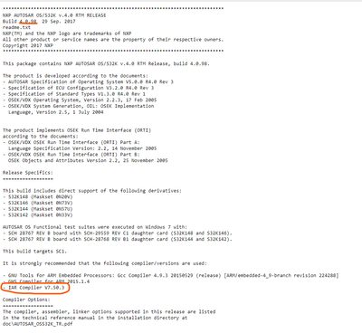

In the Release note of the AUTOSAR OS package, you can find a note of compiler requirements as below:
You should use the following version of all required tools/enviroments
I'm not so sure about the second issue but maybe it can related to the first one, so please help me to try re-install correct version of tools once again.
