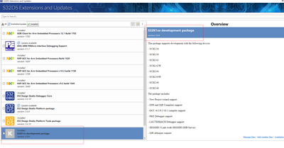

I Use the S32DS extensions and Updates to install the  S32SDK_S32K1XX_RTM_4.0.1, as below shows:

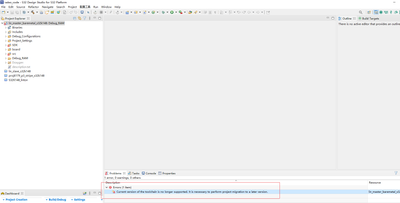

But when I start the example project it report the error below:
My question is how should I update the SDK  from S32SDK_S32K1XX_RTM_4.0.1 to S32SDK_S32K1XX_RTM_4.0.2 or S32SDK_S32K1XX_RTM_4.0.3.

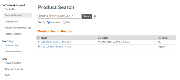

Simply go to your NXP SW account under your profile and type it to search:
Peter

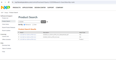

linton_xie
Hi peter,
please see the attached below:
no version 4.0.3
Am I in the wrong path?
1,823 Views
petervlna
You are on correct location. But it looks like you do not have access to that specific version.
You will need to get higher access.
For access right please refer to FAQ:
