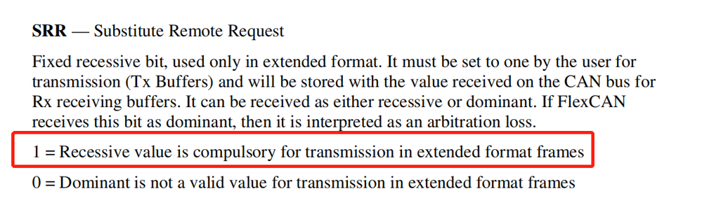

   I use the S32K144 EVB CAN to communicate with one smart sensor.The MDK is RTM 300.
  The transmit CAN frame is EXT.
  I found that the CAN bit SRR must be set to 1,otherwise the communication will fail.

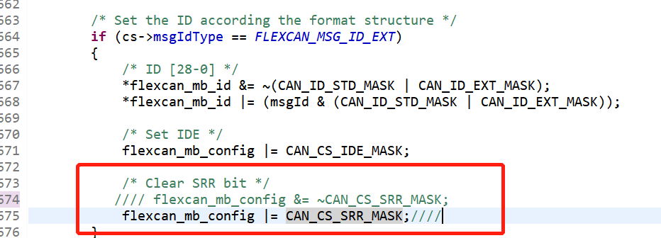

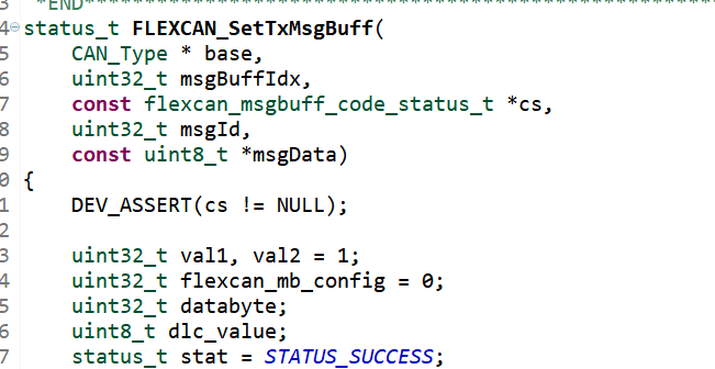

  Now, I modify the function FLEXCAN_SetTxMsgBuff like below.
  So, do you have any other way to set the SRR bit?

Hello qh c,
Unfortunately, as you mention the SDK doesn't have a way to set this bit so you would need to do these changes to the SDK.
