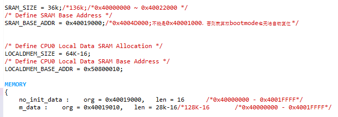

When the system jumps from application program to boot, it needs to read the data in SRAM in boot, so it is hoped that the data in SRAM in this part will not be initialized. I have tried to disable BIST,but in vain.
S32R274 is used and the memrory allocation shows as follow:

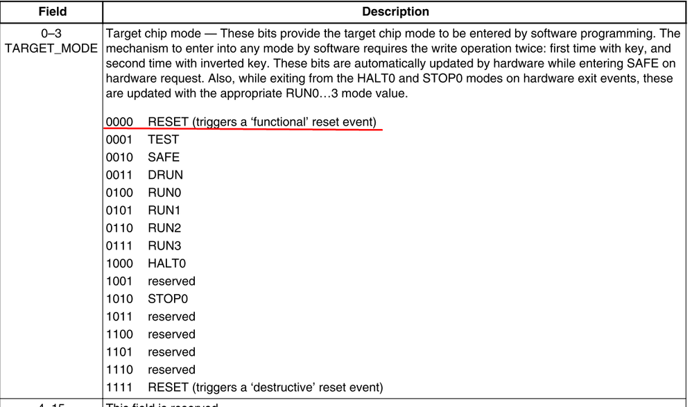

I also tried Mode Entry Module, like this (In this picature, the variable mode is equal to 0,which means it triggers a 'functional' reset event):
Yes, this is the way how it should be done.

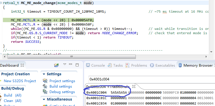

I have tried Mode Entry Module, like this (In this picature, the mode is equal to 0):.

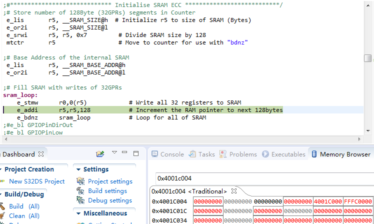

however, after reset, the startup.s was executed and the data in address 0x4001c004 was destroyed too.I don't know why.

petervlna
Sure,
Comment our ECC initialization.
That is what is causing RAM content to be destroyed after functional reset.
as the RAM data and ECC syndrome must fit together. Therefore you doing RAM initialization.

petervlna
then only way is to execute functional reset in your application otherwise the RAM content will be destroyed.
I have no idea what do you mean by hardware reset as such reset source does not Mode entry module implement.
