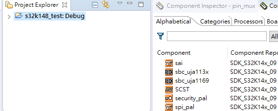

Thanks for this picture.
The problem is that you still don't have the right Processor Expert repository because probably CPU component version is 09, not 15.

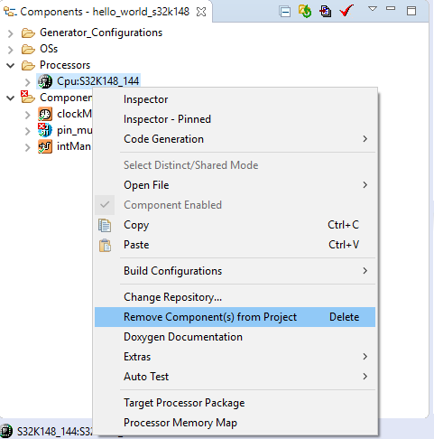

Please start a new project from our example code from RTM 3.0.0 (File-> start new project from examples).
Go in Components view-> right click on each component -> Change repository and select the right version.

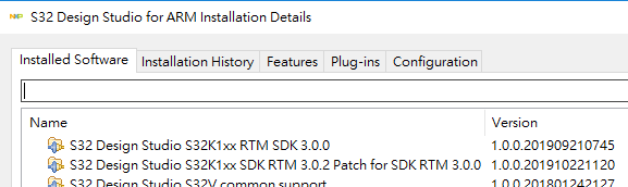

snaku_lee
Hi Razvan,

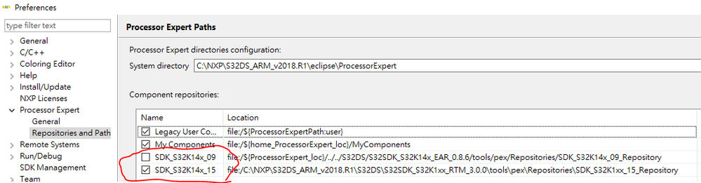

I install the RTM 3.0.2 via 'install New Software...' of the 'help' menu, I install the RTM SDK 3.0.0 and RTM 3.0.2 patch.
[ my installed software ]
It could be my installation issue,  because after I install the RTM 3.0.2, I find the Repositories path of the Process Expert still use SDK_S32K14x_09 only, I have to add the path for SDK_S32K14x_15 manually, and deselect the SDK_S32K14x_09 checkbox.
[ Processor SDK ]
Is there any way can check my SDK installed is correctly or not?

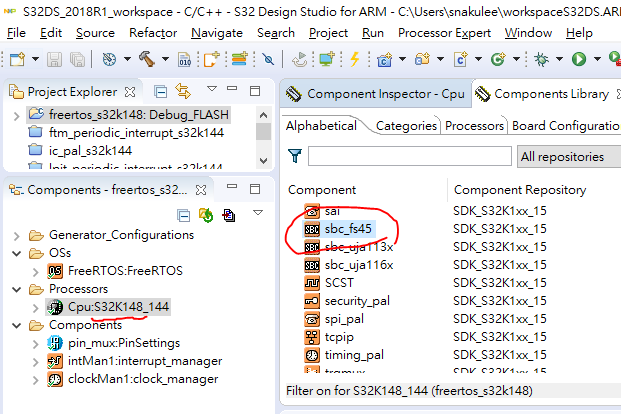

snaku_lee
Hi Razvan,
Yes, you are right, I can see the sbc_fs45 component now, and like you said, it only appear when the MCU is S32K148 with SDK_S32K1xx_15 repository, not support with S32K144.
