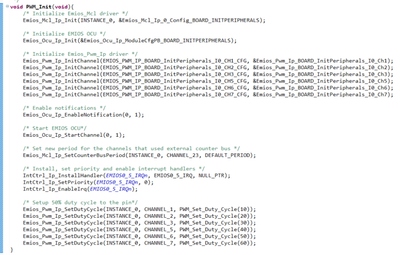

Hello everyone,
I'm using S32K344 and S32K3 RTD AUTOSAR 4.4 2.0.1 D2207.
I would like to configure the PWM as OPWMCB (Center aligned Output PWM Buffered) using 6 aligned channels and notification occurring at the beginning of cycle as circled in the image below:
I need to use the driver OCU? How I can configure using the MCUXpresso Config Tools?
I have tried to configure with this way:
I was able to do the Emios_OCU notification to work, but it doesn't look right, this isnt the same channel of PWM and I can't configure with the same.
Thanks.

@MVR A work arround that I've though yesterday and probably that I will use too is:
1. add an extra OPWMCB channel with in the same Master/Counter Bus with duty cycle 99.99%
2. enable the "Flag generation" on the leading edge of the pulse.
3. trigger BCTU with this flag generated from the leading edge of the 99.99% duty cycle pulse
4. and finally BCTU will handle the ADC conversion accordingly to your needs
I hope this helps. If you have thought any other workaround share it let me know.

Hello @kyf,
I saw the BCTU options for configuration but I didn't find any option for link with "flag generation" on PWM channel.
It seems to me that BCTU just work with ADC, doesn't it?
For example:
For it, I understand that we must work in "Internal Trigger" section, because the another sections are "Bctu ADC notification" (the name itself says it all, ADC notification), "Bctu LIST items" (if BCTU configured with conversion using list of channels in ADC, we must configure this section) and "Result FIFOs" (If configured the ADC conversion result as FIFO, we must configure this section).
So what was left was the "Internal Triggers", and all options are tied with ADC, like, if is the single conversion or not, the data destination of conversion, and so on...
Did you see my configuration using Emios_OCU? The notification worked in underflow/overflow, but not in the same channel configured on PWM. Maybe this is the way but I think that there is some simple detail disturbing it.
I was reading about Ocu today. It is a MCAL driver. You can't trigger other peripherals with Ocu. You can just create interrupt events that CPU will handle. Maybe I'm wrong but from the little time that I've studied it this is what I've understood. In order to initiate an ADC conversion with OCU you have to use the CPU.
By creating a peripheral Event you can use it in order to trigger other Peripherals do stuff without using the CPU.
1. I think that you are right. From BCTU configurations you select the eMIOS chanel that creates the trigger. And you have to set also the eMIOS PWM channel trigger accordingly to your needs from the eMIOS PWM config.
2. Also the TRGMUX connect connect the two signals together (OPWMCB flag generated from leading edge and the BCTU ).
-> Please see the image that I've attached bellow and let me know if this helps.
-> Black background is due to DevStyle addon
I think option 1 is the right solution to this, but it can also be done with option 2. I will try to test them and I'll let you know.
TRGMUX is the "guy" that connects almost everything with everything in those MCUs.
Kind regards,
kyf.
