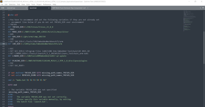

we are modifying the launch.bat like to take all path and IAR system for compiling to them.
#IAR system error
@launch.bat
@echo off
::You have to uncomment and set the following variables if they are not already set
:: uncomment line below if you do not set TRESOS_DIR over environment
::TRESOS
SET TRESOS_DIR=C:/EB/tresos/tresos_23_0_0
::MAKE
SET MAKE_DIR=C:/NXP/S32DS_ARM_v2018.R1/utils/msys32/usr
::GHS
SET GHS_DIR=C:/ghs/arm/comp_201714
::IAR
::SET IAR_DIR=C:/Tools/IAR/EmbeddedWorkbench75/arm
SET IAR_DIR=C:/IARSystems/EmbeddedWorkbench91/arm
::GCC
::SET GCC_DIR=C:\Program Files (x86)\GNU Arm Embedded Toolchain\10 2021.10
::SET LINARO_DIR=C:/Tools/Linaro/4_9_3_20150529/Linaro_Toolchain_arm-eabi
SET LINARO_DIR=C:/GNUToolsARMEmbedded/62017-q2-update
SET PLUGINS_DIR=C:/NXP/AUTOSAR/S32K14X_MCAL4_2_RTM_1_0_0/eclipse/plugins
::SSC
::SET SSC_ROOT=

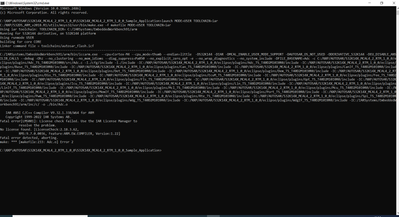

but after the compiling the
C:\NXP\AUTOSAR\S32K14X_MCAL4_2_RTM_1_0_0\S32K14X_MCAL4_2_RTM_1_0_0_Sample_Application>launch MODE=USER TOOLCHAIN=iar
we get the Licenser error IAR systems -
IAR ANSI C/C++ Compiler V9.32.1.338/W64 for ARM
Copyright 1999-2022 IAR Systems AB.
Fatal error[LMS001]: License check failed. Use the IAR License Manager to
resolve the problem.
No license found. [LicenseCheck:2.18.3.62,
RMS:9.7.0.0036, Feature:ARM.EW.COMPILER, Version:1.22]
Fatal error detected, aborting.
make: *** [makefile:233: Adc.o] Error 2
so how to solve the issue please guide earlier

Hi Swaroop_joshi,
Please add IAR license and re-build your code.
You can get this license via the iar.com website.
