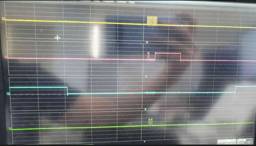

myna
Hello. Jorge Antonio Alcala Vazquez
there is current spi waveform. ( c1 : clk // c2 : mosi // c3 : CS // c4 : miso )
I think that waveform is output correctly.
but I don't know why slave doesn't receive data.
And when should I use function(LPSPI_DRV_SlaveTransfer)?
I think the slave should sync to the master.
Thank you.
Best Regards.
4,629 Views
jorge_a_vazquez
Hi MinYeop Na
The SlaveTransfer function must be called before any action of the master side. The master will output the clock and the slave should be "ready" for the transfer. Is your master able to see data from the slave side? the same data that is in the scope and the same data that was sent in the slaveDataSend variable?

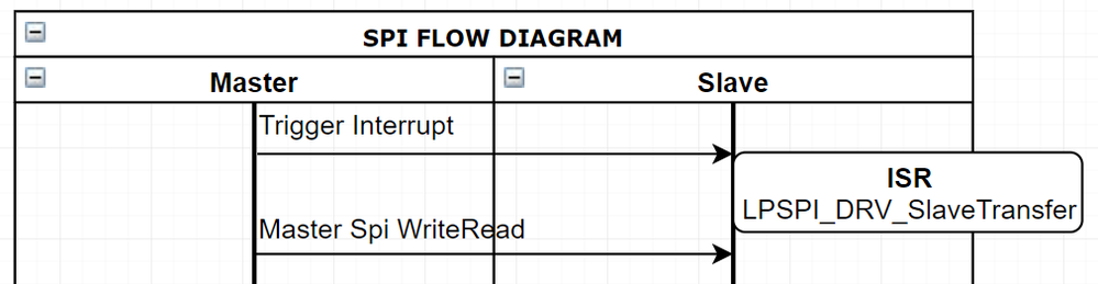

myna
Hi. Jorge Alcala
The Master Can receive well data from the slave.
But, My problem is that the Slave can not receive data from the Master.
There is Master&Slave SPI  Flow Diagram
%3CmxGraphModel%3E%3Croot%3E%3CmxCell%20id%3D%220%22%2F%3E%3CmxCell%20id%3D%221%22%20parent%3D%220%22%2F%3E%3CmxCell%20id%3D%222%22%20value%3D%22SPI%20FLOW%20DIAGRAM%22%20style%3D%22swimlane%3Bhtml%3D1%3BchildLayout%3DstackLayout%3BstartSize%3D20%3Brounded%3D0%3Bshadow%3D0%3BlabelBackgroundColor%3Dnone%3BstrokeColor%3D%23000000%3BstrokeWidth%3D1%3BfillColor%3D%23ffffff%3BfontFamily%3DVerdana%3BfontSize%3D8%3BfontColor%3D%23000000%3Balign%3Dcenter%3B%22%20vertex%3D%221%22%20parent%3D%221%22%3E%3CmxGeometry%20x%3D%22140%22%20y%3D%2220%22%20width%3D%22380%22%20height%3D%22450%22%20as%3D%22geometry%22%2F%3E%3C%2FmxCell%3E%3CmxCell%20id%3D%223%22%20value%3D%22Master%22%20style%3D%22swimlane%3Bhtml%3D1%3BstartSize%3D20%3B%22%20vertex%3D%221%22%20parent%3D%222%22%3E%3CmxGeometry%20y%3D%2220%22%20width%3D%22210%22%20height%3D%22430%22%20as%3D%22geometry%22%2F%3E%3C%2FmxCell%3E%3CmxCell%20id%3D%224%22%20value%3D%22%22%20style%3D%22line%3BstrokeWidth%3D2%3Bdirection%3Dsouth%3Bhtml%3D1%3B%22%20vertex%3D%221%22%20parent%3D%223%22%3E%3CmxGeometry%20x%3D%22100%22%20y%3D%2220%22%20width%3D%2210%22%20height%3D%22410%22%20as%3D%22geometry%22%2F%3E%3C%2FmxCell%3E%3CmxCell%20id%3D%225%22%20value%3D%22Master%20Spi%20WriteRead%22%20style%3D%22text%3Bhtml%3D1%3Bresizable%3D0%3Bpoints%3D%5B%5D%3Bautosize%3D1%3Balign%3Dleft%3BverticalAlign%3Dtop%3BspacingTop%3D-4%3B%22%20vertex%3D%221%22%20parent%3D%223%22%3E%3CmxGeometry%20x%3D%22105%22%20y%3D%2288%22%20width%3D%22130%22%20height%3D%2220%22%20as%3D%22geometry%22%2F%3E%3C%2FmxCell%3E%3CmxCell%20id%3D%226%22%20value%3D%22Trigger%20Interrupt%22%20style%3D%22text%3Bhtml%3D1%3Bresizable%3D0%3Bpoints%3D%5B%5D%3Bautosize%3D1%3Balign%3Dleft%3BverticalAlign%3Dtop%3BspacingTop%3D-4%3B%22%20vertex%3D%221%22%20parent%3D%223%22%3E%3CmxGeometry%20x%3D%22105%22%20y%3D%2220%22%20width%3D%22100%22%20height%3D%2220%22%20as%3D%22geometry%22%2F%3E%3C%2FmxCell%3E%3CmxCell%20id%3D%227%22%20style%3D%22edgeStyle%3DorthogonalEdgeStyle%3Brounded%3D0%3BorthogonalLoop%3D1%3BjettySize%3Dauto%3Bhtml%3D1%3BexitX%3D0.055%3BexitY%3D0.367%3BexitDx%3D0%3BexitDy%3D0%3BentryX%3D0.055%3BentryY%3D0.5%3BentryDx%3D0%3BentryDy%3D0%3BexitPerimeter%3D0%3BentryPerimeter%3D0%3B%22%20edge%3D%221%22%20parent%3D%222%22%20source%3D%224%22%20target%3D%2210%22%3E%3CmxGeometry%20relative%3D%221%22%20as%3D%22geometry%22%3E%3CmxPoint%20x%3D%22290%22%20y%3D%2285%22%20as%3D%22sourcePoint%22%2F%3E%3CmxPoint%20x%3D%22480%22%20y%3D%2285%22%20as%3D%22targetPoint%22%2F%3E%3C%2FmxGeometry%3E%3C%2FmxCell%3E%3CmxCell%20id%3D%228%22%20style%3D%22edgeStyle%3DorthogonalEdgeStyle%3Brounded%3D0%3BorthogonalLoop%3D1%3BjettySize%3Dauto%3Bhtml%3D1%3BexitX%3D0.25%3BexitY%3D0.5%3BexitDx%3D0%3BexitDy%3D0%3BexitPerimeter%3D0%3BentryX%3D0.25%3BentryY%3D0.5%3BentryDx%3D0%3BentryDy%3D0%3BentryPerimeter%3D0%3B%22%20edge%3D%221%22%20parent%3D%222%22%3E%3CmxGeometry%20relative%3D%221%22%20as%3D%22geometry%22%3E%3CmxPoint%20x%3D%22105.20689655172418%22%20y%3D%22130.65517241379314%22%20as%3D%22sourcePoint%22%2F%3E%3CmxPoint%20x%3D%22296.2413793103449%22%20y%3D%22130.65517241379314%22%20as%3D%22targetPoint%22%2F%3E%3C%2FmxGeometry%3E%3C%2FmxCell%3E%3CmxCell%20id%3D%229%22%20value%3D%22Slave%22%20style%3D%22swimlane%3Bhtml%3D1%3BstartSize%3D20%3B%22%20vertex%3D%221%22%20parent%3D%222%22%3E%3CmxGeometry%20x%3D%22210%22%20y%3D%2220%22%20width%3D%22170%22%20height%3D%22430%22%20as%3D%22geometry%22%2F%3E%3C%2FmxCell%3E%3CmxCell%20id%3D%2210%22%20value%3D%22%22%20style%3D%22line%3BstrokeWidth%3D2%3Bdirection%3Dsouth%3Bhtml%3D1%3B%22%20vertex%3D%221%22%20parent%3D%229%22%3E%3CmxGeometry%20x%3D%2281%22%20y%3D%2220%22%20width%3D%2210%22%20height%3D%22410%22%20as%3D%22geometry%22%2F%3E%3C%2FmxCell%3E%3CmxCell%20id%3D%2211%22%20value%3D%22%26lt%3Bb%26gt%3B%26lt%3Bfont%20style%3D%26quot%3Bfont-size%3A%2015px%26quot%3B%26gt%3BISR%26lt%3Bbr%26gt%3B%26lt%3B%2Ffont%26gt%3B%26lt%3B%2Fb%26gt%3B%26lt%3Bbr%26gt%3BLPSPI_DRV_SlaveTransfer%22%20style%3D%22rounded%3D1%3BwhiteSpace%3Dwrap%3Bhtml%3D1%3B%22%20vertex%3D%221%22%20parent%3D%229%22%3E%3CmxGeometry%20x%3D%2287%22%20y%3D%2245%22%20width%3D%22165%22%20height%3D%2255%22%20as%3D%22geometry%22%2F%3E%3C%2FmxCell%3E%3C%2Froot%3E%3C%2FmxGraphModel%3EpastedImage_3.png
MinYeop.
4,629 Views
jorge_a_vazquez
Hi MinYeop Na
Is the master using a GPIO interrupt to call the LPSPI_DRV_SlaveTransfer? Can you assure that the slave transfer function was called before master start the SPI "WriteRead" function?
This is important because our drivers are implemented in a method that if the SlaveTransfer function was not called before master start communication, then it can occur the behavior that you see where the Receive data is not received.
