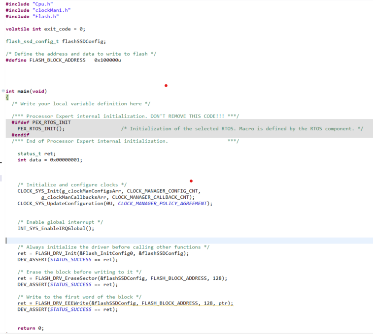

How do write the data to the flash memory in s32k148

what is the problem?Screenshot 2023-02-21 092953.pngScreenshot 2023-02-21 092953.png

Hi @joshfx,
Instead of FLASH_DRV_EEEWrite(), use FLASH_DRV_Program().
The FLASH_DRV_EEEWrite() is for the emulated EEPROM (FlexRAM in EEPROM mode) only.

joshfx
How can i read data
3,026 Views
danielmartynek
There is no API for reading the flash.
You can simply use a pointer to the flash location.

joshfx
I want to write a random data to spesific address in the flash memory but i can't
