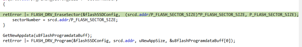

 hello:
   I made a S32K144 CAN Bootloader,However, I now receive data from the.Srec format file, erasing and writing Flash unsuccessfully;
flash init:
erasing and writing Flash:
could you give me a example about Flash to read and write?
1,407 Views
lukaszadrapa
the example can be found here:
c:\NXP\S32DS_ARM_v2.0\S32DS\S32SDK_S32K14x_EAR_0.8.4\examples\S32K144\driver_examples\system\flash_partitioning\Sources\main.c
Lukas
