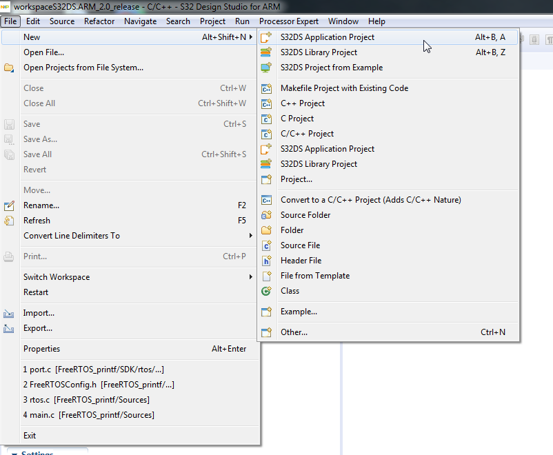

On main menu bar click on File -> New S32DS Application project

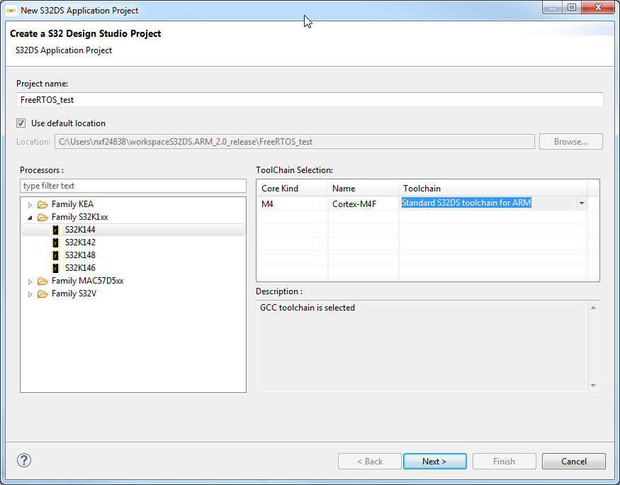

Select S32K144 device and put unique project name

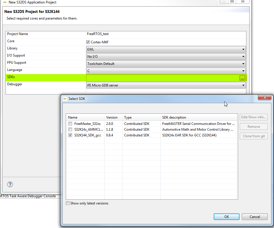

In next step select S32K144 SDK:

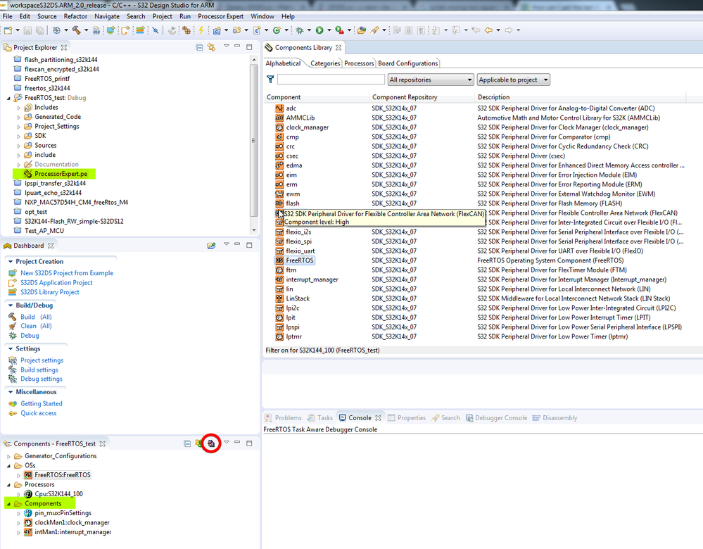

Double click on processor expert and add FreeRTOS component. Don't forget generate Processor Expert code.

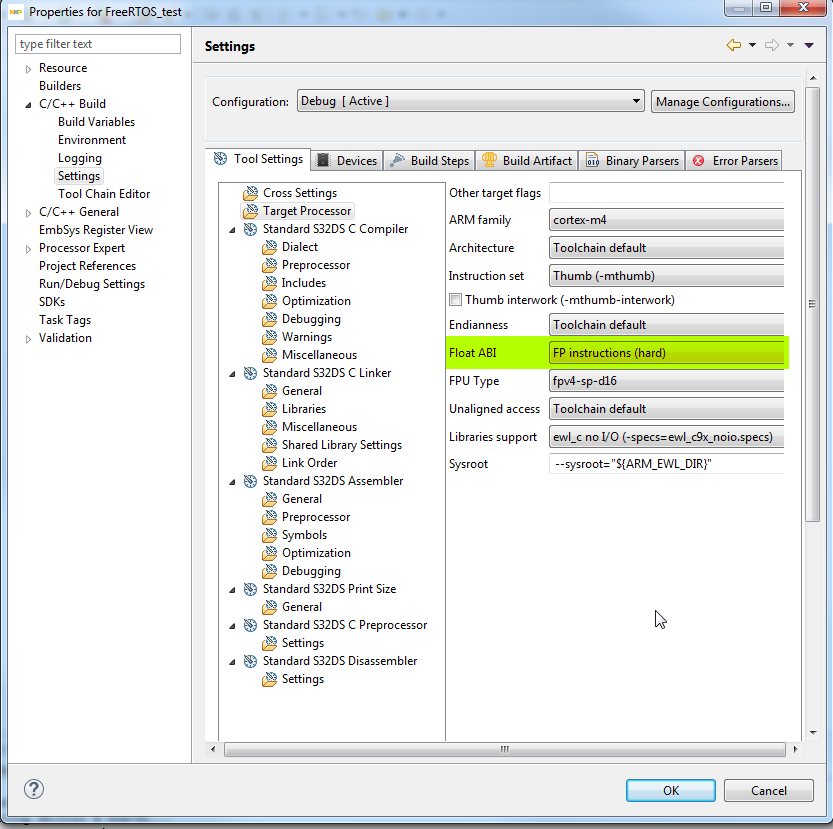

Change FPU instructions settings by right click on project name -> properties
