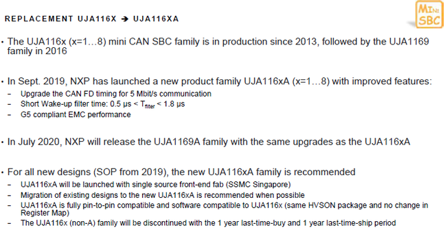

   Also, I have another question what's the difference between UJA1169x and UJA1169Ax ? I couldn't find the answer in datasheet. UJA1169 is used on my S32k144EVB board.

TomasVaverka
Hi Zhang,
Glad to hear you are now able to read the UJA1169 internal registers.
The difference is support up to 5 Mbit/s, short wake-up filter timing and improved EMC performance. They both are software/hardware compatible. Image_1.png
