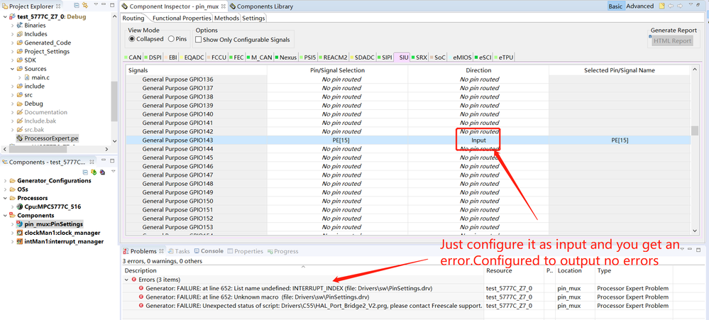

Dear all,
     I encountered a problem in S32DS For Power V2.1, and I created a new project For SPC5777C (516PIN).Configuring GPIO143 pins as input will report an error as an attachment.But When I switched to output, configured other pins, and even in S32DS For Power 2017.r1, I had the following problems.What causes this?Attached is my project.Looking forward to your reply!

Hi Yang,
This is an issue. Thanks for informing us about it.
We will fix it in our next release.
