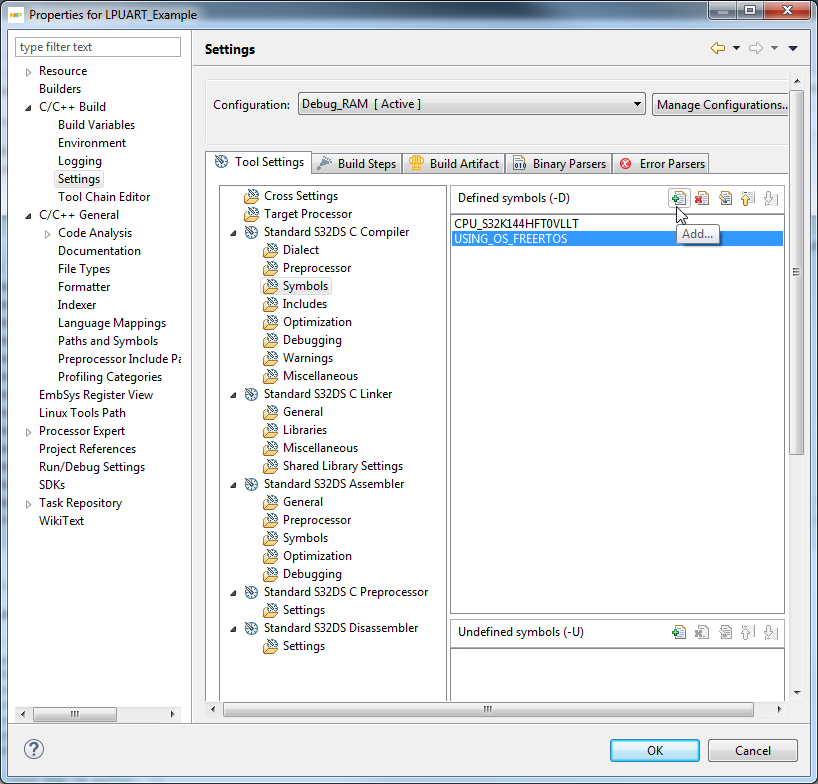

I created freeRTOS sample and then added CAN driver using processor expert.
While compiling the project, I am encountering with below error.
C:/NXP/S32DS_ARM_v2.0/S32DS/S32SDK_S32K14x_EAR_0.8.4/rtos/osif/osif_freertos.c:65:2: error: #error "Wrong OSIF selected. Please define symbol USING_OS_FREERTOS in project settings or change the OSIF variant"
Whether someone has come across this error ?

you can do exactly what is suggested in the error message - define USING_OS_FREERTOS. You can do that in project properties.
Jiri

Thanks Jiri. It worked.
