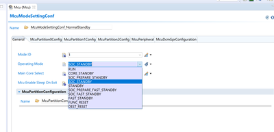

hello,
I want to put my S32K344 into STANDBY Mode, when I try to configure it on EB, I find that there are many modes of Operating Mode, but I only see that S32K344 has RUN and STANDBY modes in S32K344 RM. So I have a question, which one should I choose is the real STANDBY mode? What's the difference between these patterns? thank you.

I think the information in UM will be helpful. I'm looking on UM of SW32K3_RTD_4.4_R21-11_3.0.0 - Chapter  3.6.5 How Mcu_SetMode works when entering Low Power mode
