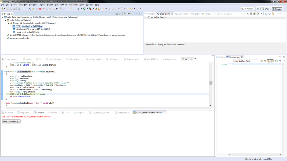

Hi there,
We try to run the sdhc_fatfs_mpc5748g demo which is included in "S32_SDK_MPC574xx_EAR_0.8.1" on our EVB (MPC574XG-MB + MPC574XG-176DS), but get error message as below:
What should we do to make it run?

martin_kovar
could you please write me content of MCSRR0 register while you are in IVOR1 exception? This could help us to identify, which instruction caused the IVOR exception.

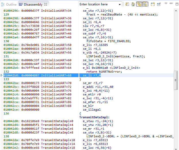

However, from the regs above, the Link Register (LR) is likely giving the needed information. Can you post the disassembly (with full opcodes) for a few rows before and after address 0x10042b8.

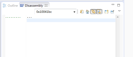

I don't know why the Disassembly window shows nothing:

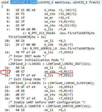

But I can tell address 0x10041bc is within function LINFlexD_2_Init whose base address is 0x10041a0:
So the address offset from LINFlexD_2_Init is 0x10041bc - 0x10041a0 = 0x1c. I disassemble uart.c and get:
If I didn't go wrong, 0x10041bc should be "se_stw  r6,0(r7)"

jamesmurray
Contributor V
I've had the problem where the Disassembly stops working numerous times. What I do to fix it, is to use the X to close that sub-window and then go back to Window -> Show View -> Disassembly to re-open it.
Assuming you've found the relevant address, that's storing the value of r6 (which is 1) into the address pointed to by r7.
r7 was just set to 0xffe90000. That is the address of LINFlexD_2_LINCR1 (from page 1891 for MPC5748G RM) so that looks ok to me? (The problem I had was that the supplier header file pointed to reserved addresses causing a crash.)
Probably best to set a breakpoint at the start of that function and single-step to see exactly where it is bombing out.
The lines at 0xc and 0x12 aren't complete in that disassembly because they haven't been linked yet.

jamesmurray
Contributor V
Sometimes the indication here can be misleading. Earlier I said "LR=0x10042b8" so look there... well that's what the disassembly window is doing, but that's the wrong place. (It is the return address where the code would go _after_ LINFlexD_2_Init had completed.)
What you had earlier with "LINFlexD_2_Init is 0x10041bc - 0x10041a0 = 0x1c." is the correct place to be looking.
Put a breakpoint just before the call (e.g. line 130 "fifostate = FIFO_ENABLED"), re-run the code and when the breakpoint hits, step into LinFlexD_2_Init and keep stepping until it goes wrong.

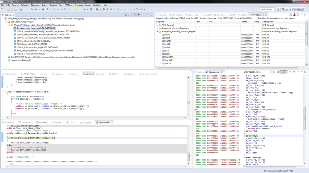

jeromeli
I did exactly what you said, the interesting thing was that when I ran it step by step, it didn't go to exception anymore. It executed the whole LINFlexD_2_Init function without any mistake. Then I let it run freely again, and it finally stopped at DevAssert, see as below. Totally beyond my understanding :smileysilly:
