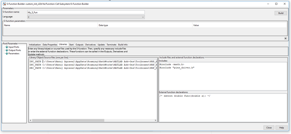

I am trying to create "S-function builder"  blocks in the MBDT for S32K144 to call some of the S32_Platform_SDK functions to implement some of the functionalities which are not available yet with the Simulink blocks provided with the MBDT. I may also want to change how the peripherals are implemented by leveraging the SDK functions.
However, I am facing the following issues:
  1. Since, the paths to SDK include and source folder has spaces in them; INC_PATH and SRC_PATH change (as in the attached before and after images) in the "Library/Object/Source files"  section of the "S-function builder" library dialog box when I build the model; hence, headers files are not found while building and an error is thrown.pastedImage_4.pngpastedImage_1.png

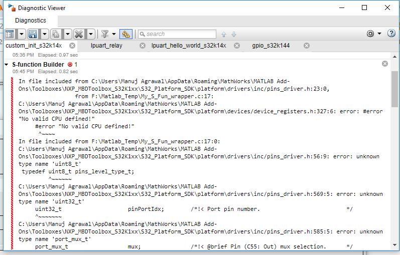

  2. Source code and Wrapper files are generated by the s-function builder just outside the folder in which the Embedded Coder generates the code, hence some macro declarations (which are found in the generated code) are not visible to the C file of the generated S-function.pastedImage_5.png

1.Since, the paths to SDK include and source folder has spaces in them; INC_PATH and SRC_PATH change (as in the attached before and after images) in the "Library/Object/Source files"  section of the "S-function builder" library dialog box when I build the model; hence, headers files are not found while building and an error is thrown.
A: You can add the paths even if they have spaces in them, using INC_PATH, etc. The only thing that I have to mention here is that they have to be on the same line - e.g.:
INC_PATH C:\ccr\mbdt_ccr\S32K\src\S32_Platform_SDK\plat form\drivers\inc
So this is a one-liner, and the next path has to be on the next line, etc.
2.Source code and Wrapper files are generated by the s-function builder just outside the folder in which the Embedded Coder generates the code, hence some macro declarations (which are found in the generated code) are not visible to the C file of the generated S-function.
A: When you click on Build inside the S-Function Builder, it generates the files (.c, .tlc, .mex, .m) inside the current folder. I'm not aware of an option from which you can select where to generate the code for your custom S-function. You can try and ask this on the mathworks forum, or you can copy the files generated (after you clicked on Build from the S-Function Builder block) to the model_name_mbd_rtw folder generated by our toolbox (manually), and then build your model.
Another thing I have to mention here is that I'm not aware of an option where you can enter compile options. For example, device_registers.h needs a define to be made (e.g: CPU_S32K144HFT0VLLT or CPU_S32K142, etc.).  Unfortunately sfunctionwizard is not officially supported (like mathworks staff member states here).
