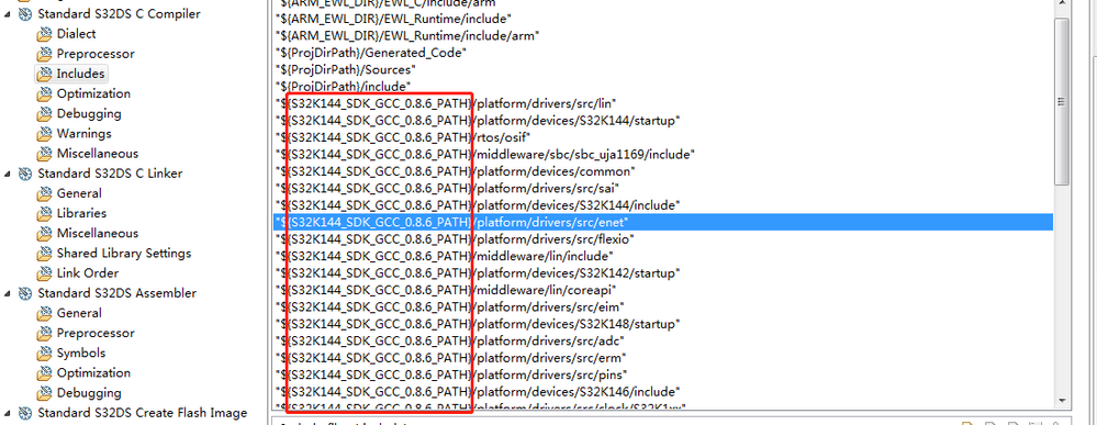

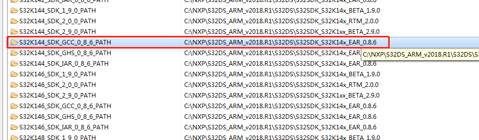

The SDK path variable what i can see in S32DS is "S32K144_SDK_GCC_0_8_6_PATH". See the picture below:
Figure 1: Linked Resources
But in the project setting, the SDK path variable used is "S32K144_SDK_GCC_0.8.6_PATH".
Figure 2: Project setting
You can see that the '_' is replaced with '.'.  Could you tell me the rules of the substitution ?

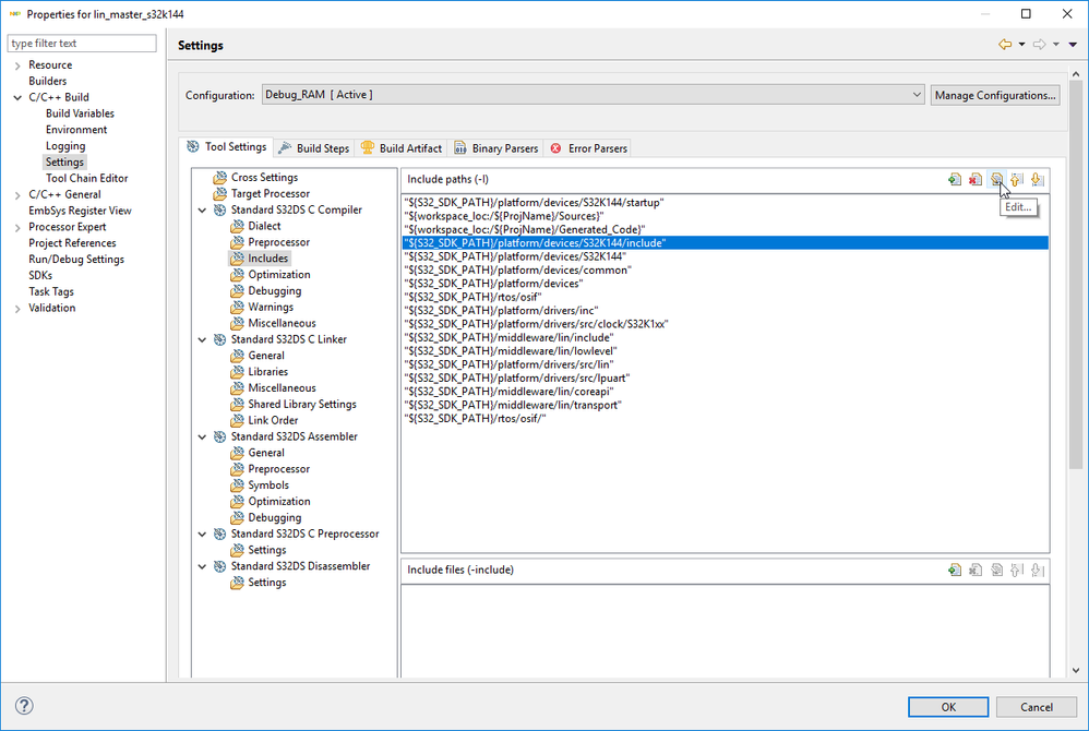

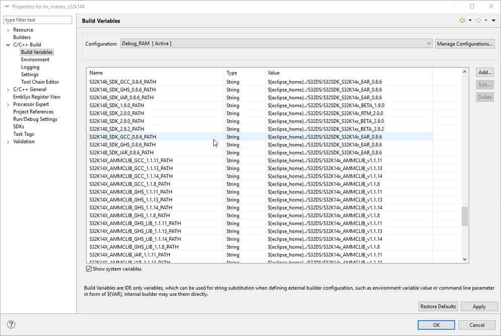

I checked build variables, but on my machine there is variable name with dots:

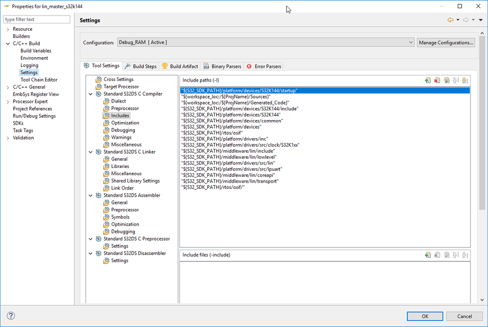

and in Includes I have only SDK path without any version specification:
What is your S32DS version? Are you using example or your own project? To fix the issue - edit variable name in Include path and set correct name:

I found the build variable now.
I didn't select the checkbox of "Show system variables", So there's nothing showed in the list.
I can't find any Build Variables, So i think the Linked Resources path are the Build variables paths.
Thanks a lot.
