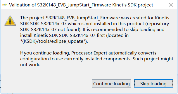

I just got the S32K148EVB board.
I want to test the Freemaster accroding to the "S32K148EVB-QSG" manual, like this:
I have burned other test programs, so I need to burn the original demo program "S32K148_EVB_JumpStart_Firmware" right now.

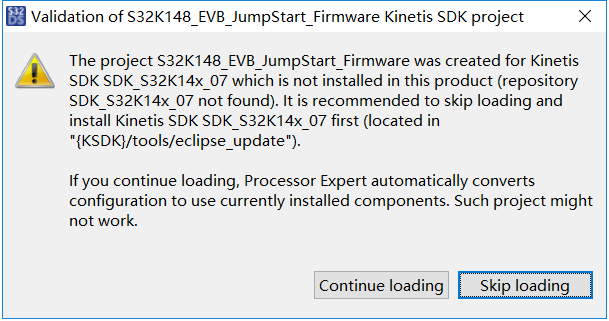

But I got the error below:

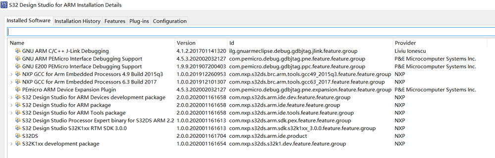

My environment is:
S32 Design Studio for ARM  Version: 2.2
What should I do?

this project is for older SDK and S32DS - please install S32DS for ARM v2018.R1  https://www.nxp.com/webapp/swlicensing/sso/downloadSoftware.sp?catid=S32-DS-ARM_v2018

hello,Jiri
Nice to see you again.
Actually I have installed both v2018 and v2.2.
When I use the v2018R1, the problem is still there.
The environment is v2018R1+update11.
Can you help me ?
Thanks!
Lu

From the EVB's pdf is this example based on S32K14x EAR v0.8.6 SDK - if I'm correct - this version is part of S32DS v2018.R1 Installation. Please check if this version is present - try to open SDK based example project.

Hi,Jiri
You are right. v2018+update11 does has the S32K14x EAR v0.8.6 SDK.
But the error is still there.
The error information say it need the S32K14x_07 SDK ?

um - actually have no Idea which particular version is this example looking for (from pdf it loos that for 0.8.6). I'll move your thread into S32 SDK space - hope someone from SDK team can aswer it.
