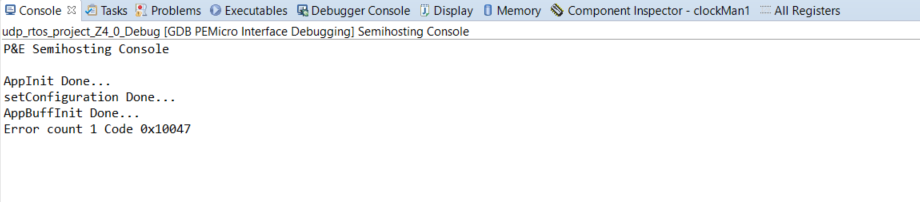

We are getting an error output like this. When I convert hexadecimal to decimal and search in rsdk-
status.h file; it says that the problem is caused "RSDK_TEF810X_SPICRCFAILED"
We think that the problem is caused because of SPI sent data and read data does not match. So this error occurs because of CRC check.

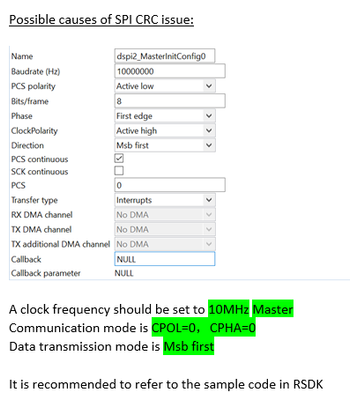

Here is the feedback from RADAR expert:
You use the RSDK_ DEMO, which is fully adapted to RDK hardware without any modification. One thing may not be clear: 10M refers to the baud rate, and the default value is also 10M SPI clock should be configured as 80MHz or 100MHz.
The best suggestion is that you first use RDK hardware for testing, and then do your hardware. RDK hardware has been used in exhibitions for many times, running RSDK_ DEMO has no errors.
We usually don't spend too much time supporting customers' own hardware, because it also involves hardware reliability, which we don't know.
If you has just started to develop radar application, I suggest they choose S32R294 with better performance and lower price. This part has also been completely developed and has complete demo and files.

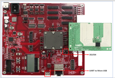

The following are two sets of hardware that can be used for radar evaluation:

Here is the feedback form RADAR team:

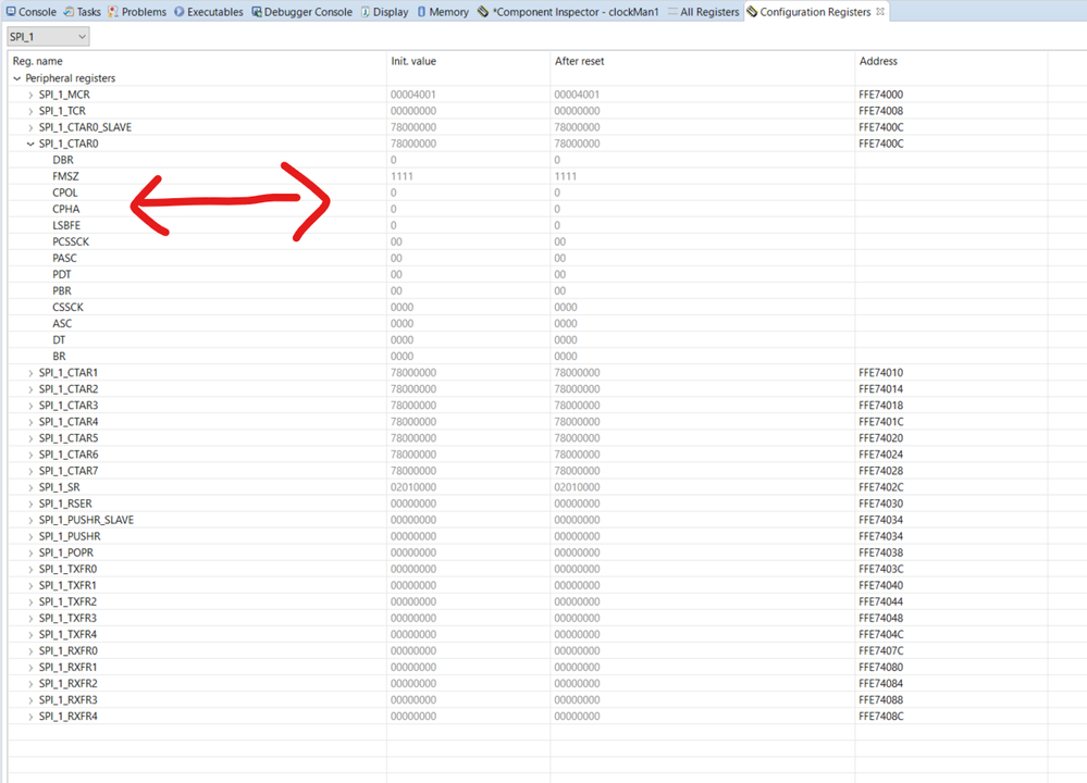

As you can see the below pictures, we still get the same error which is "10047x RSDK_TEF810X_SPICRCFAILED"
Any other help will be appreciated.

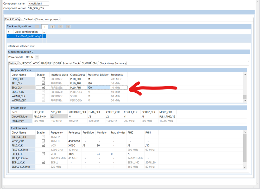

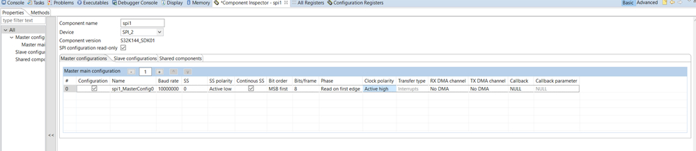

Spi master configurationSpi master configurationSpi Clock FrequencySpi Clock FrequencyCpol and CphaCpol and CphaCrc OutputCrc OutputCrc OutputCrc OutputErrorError

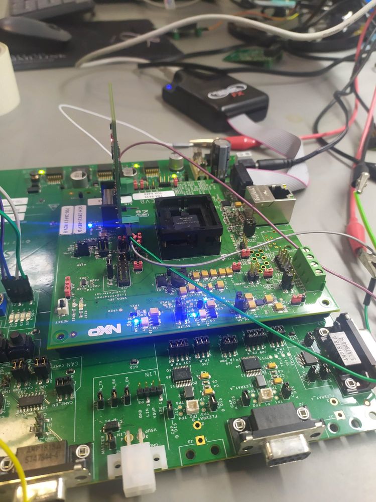

Yes we developed another PCB with tef810x and connected it via MIPI/CSI 2 connector on the evaluation board. We are trying to communicate S32R274 MCU with our own PCB's TEF810x. We sent SPI data from evaluation board to our board and we can see all signals(SPI) are matched in the both PCBs. But when we try to debug our PCB connected to the we seen an error on the S32DS as "10047x RSDK_TEF810X_SPICRCFAILED".
We think that this problem is caused because of our S32 microcontroller unit is not sending correct SPI clocks but not sure about it.
And yes we now about RDK but at the moment we are not using it. We are using s32r274evb evaluation board and our own design PCB with TEF810x

Also as you can see this picture of our debugging setup with S32r274evb and our design  RF board with TEF810x.
We can not observe the SPI's clock signal as a clock we only observe it as a active high signal.
