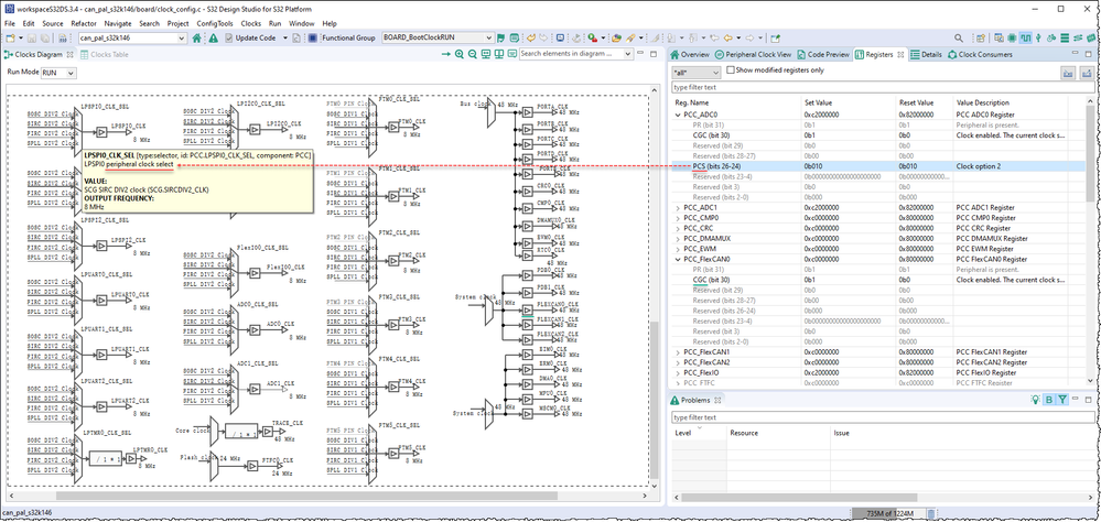

In generated clock_config.c by the almost all peripheral unit the setting clkSrc is CLK_SRC_OFF
Clock settings:
config_clock.c
.clockName = FlexCAN0_CLK,
.clkGate = true,
.clksrc=CLK_SRC_OFF,
.frac = MULTIPLY_BY_ONE,
.divider = DIVIDE_BY_ONE,

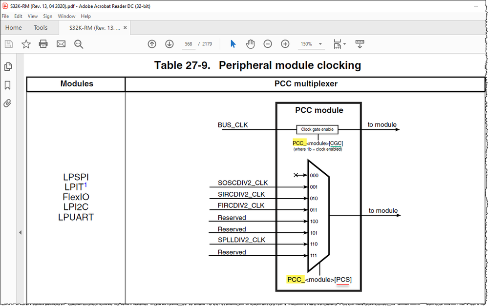

Hi Denis,
For those peripheral units exist PCC_<module>[PCS], the .clksrc will show the selection of PCC_<module>[PCS].
The .clksrc=CLK_SRC_OFF, for those peripheral units without PCC_<module>[PCS]. Only shows the state of Clock Gate Control PCC_<module>[CGC].
Robin

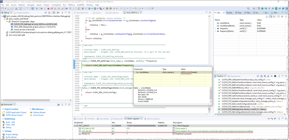

The the problem is something elsewhere. I have namely the problem that the various clocks are not runned, altough they are configured and initialized.
Then I have created the new project from example lpi2c_master and the function CLOCK_SYS_GetFreq in LPI2C_DRV_MasterInit return STATUS_MCU_GATED_OFF.

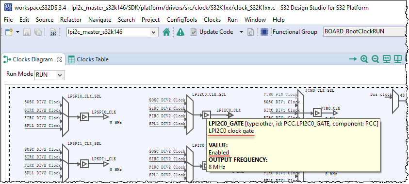

Please check if the LPI2C clock gate is Enabled in Clocks Tool.
During debug, you will find the LPI2C clock gate is Enabled in CLOCK_DRV_Init(&clockMan1_InitConfig0); I did not meet the issue that you mentioned.
