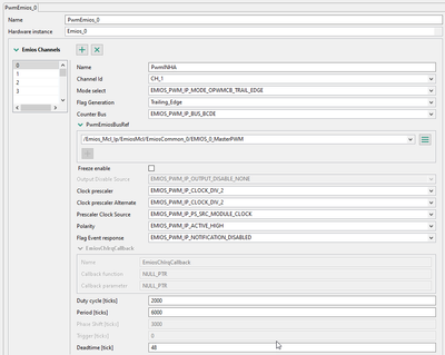

when using a EMIOS channel in EMIOS_PWM_IP_MODE_OPWMCB_TRAIL_EDGE_FLAG mode setting dutycycle with  Emios_Pwm_Ip_SetDutyCycle to 0 sporadically causes 100% on the channel.
Steps to reproduce:
1. set dutycycle to 1 for n periods: Emios_Pwm_Ip_SetDutyCycle(0,1, 1 );
2. set dutycycle to 0: Emios_Pwm_Ip_SetDutyCycle(0,1, 0) ;
--> channel goes to 100%
suspected root cause:
dutycylce = 1 causes A register to go to 3001 --> output flipflop is on on the first tick.
dutycylce = 0 causes A register to go to 3002 (never reached)  --> output flipflop stays on forever.
critical line in RTD(Emios_Pwm_Ip_SetDutyCycleOpwmcb
main code:
     dutycycle = (potiValue/1000*6000); // val / max potival * max duty ticks
    if(dutycycle == 1) // workaround 100% at 0 duty bug
    dutycycle = 2;
Emios_Pwm_Ip_SetDutyCycle(0, Emios_Pwm_Ip_I0_Ch1.ChannelId, dutycycle);

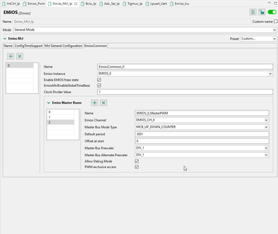

RTD config:
* Project : RTD AUTOSAR 4.7
* Platform : CORTEXM
* Peripheral : Emios Flexio FlexPwm eTpu
* Dependencies : none
* Autosar Version : 4.7.0
* Autosar Revision : ASR_REL_4_7_REV_0000
* Autosar Conf.Variant :
* SW Version : 5.0.0
* Build Version : S32K3_RTD_5_0_0_D2408_ASR_REL_4_7_REV_0000_20241002
