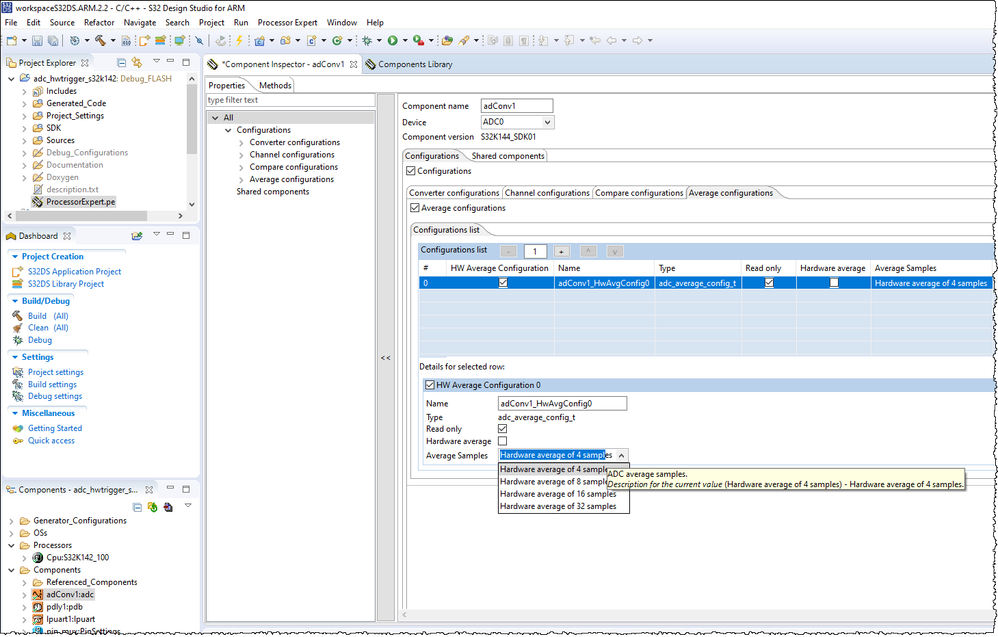

You can find the Hardware average feature here:

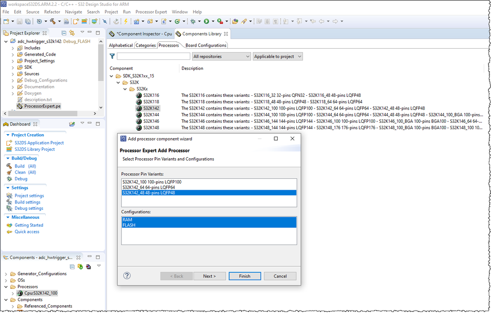

About 48 pin controller, please refer: How to change package on S32DS Processor Expert

I guess you are confused I need to configure the ADC PAL using processor expert and not ADConv. Please check the attached image for your reference.

The ADC PAL driver does not provide setting for HW average/compare functions.
I am afraid you need to add this function by software codes.
