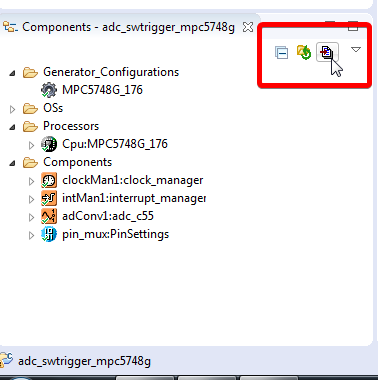

My IDE is S32 Design Studio for Power Architecture.
I import an existing project from the offical library,such as Hello_World,when build it,it's always get a lot of Errors.
The first item is "No such file or directory" in main.c to the code "#include "Cpu.h"".
I can not find Cpu.h in project directory and C:\NXP\S32DS_Power_v2017.R1\.
4,883 Views
jiri_kral
you probably forgot generate processor expert code before you build project:
Jiri

everkimage
The project "Hello_World" is OK.
The error comes from Example Project of MPC57xx EAR SDK and i have already installed "S32 Design Studio for Power Architecture® 2017.R1 – Update 1".
4,884 Views
jiri_kral
Jiri

kevinelgin
This is how to get the view Jiri has referenced:
