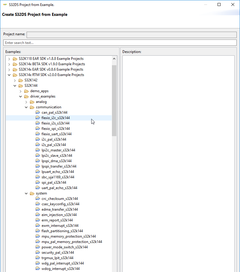

I would implement flexio_i2c on my exist project. i selected two pin as SCL/SDA, then generate code, but when i #include "flexio_i2c.h" and compile, it reports "../Sources/main.c:21:24: fatal error: flexio_i2c.h: No such file or directory"
Why? can anyone know the steps to using flexio_i2c?

There is probably missing path to your header file. You can look at example project for reference:
