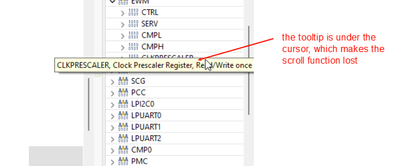

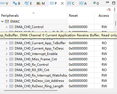

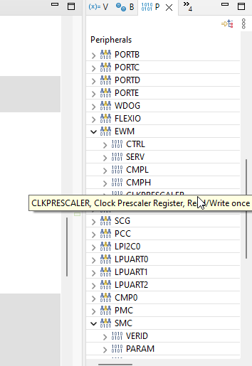

hello, experts.
i met a problem when i peripheral registers view in s32ds v3.6.3.  The view is docked on the right of the main view and the with is a little narrow. when the cursor is over a register name, the tooltip appears and just under the cursor, then view can not be scrolled. i have to move my cursor and then scroll again. i think the tooptip got the focus at that time. is there any solution?
best regards!

sorry for delay. You can simply make the view wider or drag and drop the Peripheral registers tab to better place - for example down next debug console.
If there is some strange settings in debug perspective - reset the perspective. Window -> Perspective -> Reset Perspective.
I tested it with S32DS v6.4 and tooltip works as expected:

my issue is that when the tooltip appeared, the view can not be scrolled.
